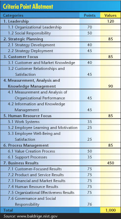

The Baldrige criteria consist of seven key indicators of success. Winners are selected on a 1,000-point scale for their achievements in all categories, so if one indicator is lacking, the chances of winning a Baldrige decreases. The criteria include:
Leadership. This category takes a look at how top management guides the organization toward best practices.
Strategic planning. The organization must set strategic goals toward excellence and determine action plans.
Customer and market focus. This criterion examines how customers and markets are acquired, satisfied and retained.
Measurement, analysis and knowledge management. The organization must show effective management, use, analysis, and improvement of data and information to support its processes and performance management system.
Human resource focus. How does the organization empower and retain its workforce?
Process management. The organization must effectively design, manage, and improve its production/delivery and support processes.
Business results. This category studies the ways in which the organization performs against competitors. It examines performance in all key business areas, including customer satisfaction, financial and marketplace performance, human resources, partner performance, operational performance, governance and social responsibility.

Although Schonberger gives great praise to the MBNQAP, he says the criteria are too focused on business results and not focused enough on quality. As it stands, the customer and market focus category counts for 450 of the criteria’s possible 1,000 points.
“The category of business results shouldn’t be in the criteria at all,” he argues. “Of course we want a quality award to be given to companies that are successful in business, but that’s mixing means and ends. It gives the impression that organizations aren’t sure that quality is the right thing to do, so they have to prove it with financial results. It reflects a basic doubt that quality really works.”
Although Schonberger believes the criteria’s evolution is causing instability and an overall drift from quality management, he is pleased with some recent changes. For example, he’s glad to see the “business process” portion of the process management criterion eliminated. “Although the process management category only accounts for 85 of 1,000 points, getting rid of business process requirements helps companies focus purely on quality.”
Another change he applauds is the weight of item 7.1, customer-focused results, which counts for 75 points. Financial and market results also count for 75 points, which Schonberger says is a step in the right direction.
