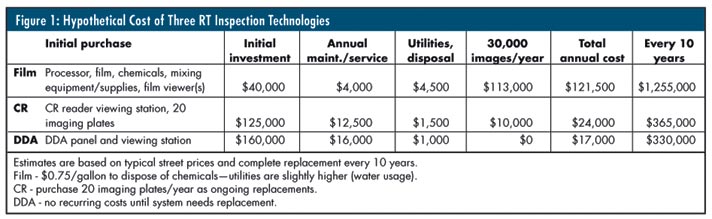

Comparing the cost of radiographic systems for nondestructive testing is a matter of apples and oranges--and bananas and sometimes the banana tree itself. Equipment cost and useful life vary substantially for the various options, as do costs for consumable goods.
Analog film users, of course, must keep buying consumables--film and chemicals. They also maintain film processors, which generally take up more floor space and require more elaborate facilities (e.g., plumbing, ventilation, and chemical collection, treatment and/or disposal) than the facilities and associated necessities for computed radiography. Film use also creates environmental and regulatory issues related to effluent discharge, along with inspections and the risk of fines.
The transition to digital technology requires an initial investment for a CR reader, which likely will cost more than a film processor. On the other hand, processors don't last as long as readers, and they require periodic replacement. Converting to CR doesn't always eliminate the need for film images, which are digitized after processing, meaning you may end up supporting (and paying for) two systems.
The greatest cost savings potential, by far, is in the elimination of film and chemicals when a lab goes completely digital. Again, buyers face a trade-off: A single CR imaging plate can cost a hundred times more than a sheet of film. The good news is that the storage phosphor plate can be erased after each use, allowing thousands of repeat exposures.
The lifetime of a storage phosphor plate varies as a function of environment, cleanliness and handling. With proper care, an imaging plate's lifetime will extend to thousands of cycles. Conversely, imaging plates will sustain damage during the normal use cycle, and we must consider them consumables--but only after they pay for themselves many times over in cost savings. DDAs used in direct digital radiography are even more expensive, but they may also last longer than phosphor plates.
From a cost-savings perspective, the case for transitioning to digital is obvious. The calculation is fairly simple: Determine the current and future film volume and associated costs, and compare those with the expense of a digital system.
A couple of pitfalls loom, however. In today's changing business environment, forecasting future production volume is challenging. One high-volume film user underestimated an impending decline in production. After calculating a reasonably favorable return on investment (ROI) and taking the plunge to digital, his business declined. Years later, he's still waiting for his ROI.
Another user reported that he was reluctant to make the full transition, so his company retained its film radiography capability. Without completely eliminating the expense for operating the processors and purchasing film and chemical consumables, the savings realized by the company weren't quite enough to pay for the transition to digital. Thus, its digital operation became an incremental expense rather than a savings.
Price realities
The price of DDA systems with flat-panel detectors has come down recently, so DDA is becoming increasingly popular and may progressively replace CR. An entry-level DDA system might cost about $80,000, which typically includes a monitor and software; some high-end systems can cost as much as $150,000. DDA technology also requires selenium and silicon detector panels, another $60,000 each.
In comparison, a CR system typically ranges between $112,000 and $125,000. Scanner technology is purchased separately and costs about $48,000. Typical imaging plates cost several hundred dollars apiece. CR plates are capable of thousands of exposures if handled properly but will most likely require replacement after two to three years of use. Therefore, cost differences between CR and DDA systems are marginal and depend on brand and model type.
Film expenses are a different story. Film users, of course, must keep buying consumables--e.g., film and chemicals, which if eliminated can save buyers a tremendous amount. Film users also must maintain film processors, which generally take up floor space and require elaborate facilities.
When comparing film and CR applications, it helps to know that CR systems will take about 18 to 24 months to pay off, depending on the amount of film a user typically consumes in a year. CR scanners cost more than film processors, but the latter must be replaced periodically, whereas CR scanners last several years. The same applies when buying phosphor plates: A single imaging plate can cost a hundred times more than a sheet of film. But because CR plates can be erased after each use, they end up paying for themselves many times over. Thus, from a cost-savings perspective, going digital is a smart and worthwhile investment.
