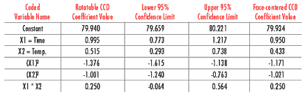

                                                            |  |  Table 2 presents the estimated regression model coefficients and corresponding
                                                    ±95-percent confidence intervals from Example 14-2 of Design and Analysis of Experiments by Montgomery for the yield response. The last column in the table
                                                    presents the estimated coefficients using a 13-point face-centered CCD for the same variables. The actual yield data from Example 14-2 were used for the center
                                                    points and factorial design points that the two designs have in common. Predicted yield data were used for the face-centered axial design points. The predictions were
                                                    obtained using the regression model from Example 14-2 with a correctly propagated experimental error added to each predicted value. As the Table 2 data show, the
                                                    face-centered CCD coefficients are all within the rotatable CCD coefficient ±95-percent confidence intervals. In fact, a comparison of the estimated
                                                    coefficients for the two design types clearly shows that they are either identical or nearly so in all cases.
