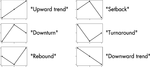

Did you know that, given three different numbers, there are six distinct ways they can appear? The graphs below show the possibilities, along with several very common terms used to “explain” them.
The question isn’t whether the numbers differ from one another. The deeper question should be, “Is the process that produced the third number the same as the process that produced the second and first numbers?”

As you can see, calling a sequence of three observations that all either increase or decrease a “trend” without a context of variation has a 33-percent risk of being random--or two out of six random possibilities.
Statistical theory tells us that in the absence of a context of variation (as is the case in most managerial meetings), it takes a sequence of six consecutive increases or decreases to declare a trend (with 20 data points or fewer, you may use five).
