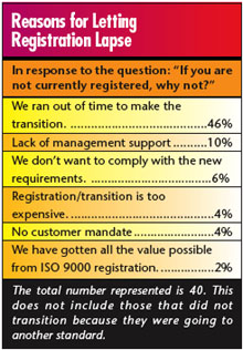

It’s no surprise that the primary reason given for missing the deadline is that the companies simply ran out of time. Of those companies that lost their registration (which excludes companies that are going to another standard, such as ISO/TS 16949), 47 percent reported that they ran out of time. Other reasons were spread fairly evenly: too expensive, no perceived value, plant closures, no customer mandate and so forth.

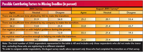

Interestingly, although lack of time was the key issue, most respondents blame their companies and not the International Organization for Standardization’s deadline for missing the transition date. Responding to the statement, “There was insufficient time allotted by ISO to make the transition,” responses were evenly distributed among disagreeing (34%), agreeing (30%) and neutral (31%). On the other hand, in response to the statement, “There was insufficient time allotted by my company to make the transition,” the majority of respondents (54%) agreed, and just one-fourth (25%) disagreed.
Companies didn’t seem to blame their registrars for missing the boat either. Nearly 45 percent of those that missed transition felt their registrars had been proactive in helping them make the transition. Only 17 percent felt their registrars weren’t proactive enough, and 38 percent were neutral.
That said, the percentages from the 2004 survey were much tamer than those from the August survey, in which respondents more strongly disagreed with both of the statements (a difference of about 20 percentage points, as illustrated in the chart below). This could be reflective of a “no problem; we’ve got plenty of time” attitude that may have existed five months before the deadline. Having missed the deadline, respondents may now be more critical of it.

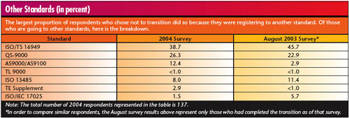

By far, the most prevalent standards to which companies were registered other than ISO 9001:2000 were ISO/TS 16949 and QS-9000. Of those companies registering to another standard, 39 percent reported they’re registering to ISO/TS 16949 and 26 percent with QS-9000.
For those planning to register to ISO/TS 16949, there was no need to become registered to ISO 9001:2000 because the new automotive standard already includes all of ISO 9001:2000. However, the Big Three’s mandated deadline for becoming registered to ISO/TS 16949 is as far away as 2006, providing extra time for companies to get their quality management system into shape. For organizations that are already registered to QS-9000, their ISO 9001:1994 registration remains valid until they transition to ISO/TS 16949.
