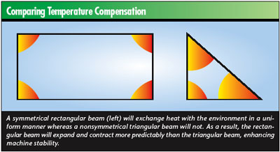

Achieving optimum stability in a structure such as a CMM requires a detailed analysis of every component in the structure. Even the shape of a beam can make a significant difference in its thermal and dimensional performance.
For example, corners tend to be thermal stress points because they heat and cool more quickly than flat surfaces. As a result, rectangular structures tend to be more stable than triangular structures because the corner-induced stresses are symmetrical.
However, triangular structures are both lighter and less expensive than rectangular structures of the same capacity because they contain less material. They’re also easier to fit with preloaded air bearings, as illustrated on page 41.
A cost-driven design will choose triangular beams, whereas performance-driven design will choose the more costly rectangular beams. Over the long run, however, the more expensive design will prove to be the more cost-effective because it’s substantially more stable, and that means it requires fewer recalibrations and delivers more usable uptime. In the end, stability translates directly into reduced measurement costs for the end-user.

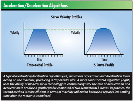

Although software-based compensation systems are rapidly nearing the point of diminishing returns, the same cannot be said for software-based motion control efforts. Today, most CMMs use a simple acceleration/deceleration algorithm that produces a trapezoidal plot. The strategy is to accelerate to maximum velocity as quickly as possible, maintain that velocity as long as possible, and then decelerate to zero as quickly as possible, as illustrated below.
At first glance, this strategy might appear to deliver optimum cycle times. After all, going as fast as possible should be the key to getting from point A to point B in the minimum amount of time; in a large, robust structure, it may well be.
But CMMs are not large, beefy structures. For a CMM, this strategy produces a substantial wait at the end of the motion while the machine “settles down” and dissipates the stresses and vibration generated by the acceleration/deceleration process.
A better strategy is to control the motion to produce a pair of gentle “S curves” during acceleration and deceleration. In practice, this approach may add a fraction of a second to the traverse time from point A to point B, but this will be more than compensated for by the reduction of waiting time once point B is reached.
In an intermittently used laboratory machine, the difference may be negligible. But, in a production-monitoring application, which fully utilizes the CMM’s capabilities, the difference in cost-per-measurement can be substantial enough to pay for the more sophisticated capabilities in a short time.
