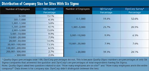

The majority of the survey results can be seen in the tables throughout this article. Rather than explain all the results in detail, we'll leave it to you to look at the tables while we focus on what we believe are two of the most interesting findings: the lack of small companies pursuing Six Sigma and why those who are using Six Sigma seem to stop after three or four years.

Despite plenty of press, anecdotes and even surveys showing huge Six Sigma successes, fewer than one-quarter (22%) of all companies we surveyed have a Six Sigma program in place. Ninety percent of the companies that do implement Six Sigma are units, divisions or sites of larger organizations. Of those, three-quarters belong to organizations with more than 2,000 employees.
According to 1997 U.S. Census Bureau statistics, 98 percent of U.S. firms had fewer than 20 employees, and 82 percent grossed less than $1 million in sales in 1992. More than 30 percent of all sales or receipts for U.S. companies come from companies with fewer than 100 employees. If Six Sigma is truly yielding huge savings for the companies that use it, then it stands to reason that small businesses need Six Sigma in order to achieve the kind of cost savings and increased profitability enjoyed by large-company Six Sigma practitioners. By extension, this would aid the U.S. economy as a whole.

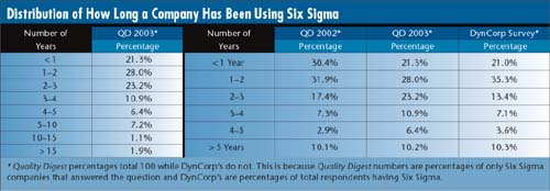

Our 2001 and 2002 surveys and the DynCorp survey show a drastic drop in the percentage of companies using Six Sigma after the second or third year, as shown above.
There are several possible explanations for the drop. The first is that although Six Sigma has been around for a while, it has only gained mainstream popularity within the last few years. This is due to press coverage of Six Sigma successes at giants like GE and Motorola and the millions of copies of books on the subject sold by Chowdhury, Harry and others. What we could be seeing is the ramp-up of Six Sigma adoption.
Another explanation is that companies are abandoning the program. Not tying Six Sigma projects to corporate goals and/or not leading the Six Sigma initiative by top management almost guarantees the program will fail, say our experts.
