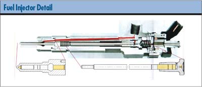

A fuel injector is fundamentally a highly sophisticated needle valve (See below). Injector ports at the bottom of the valve direct the fuel into the combustion chamber in a precisely controlled pattern, and a solenoid or piezoelectric actuator opens and closes the valve. Precision mechanical surfaces include the guide bearings, cylindrical surfaces on the shaft of the needle and body that control the needle's alignment; and the valve surfaces, mating conical surfaces that control the flow of fuel. Thirty-thousand psi operating pressures require form tolerances on these surfaces as tight as one micrometer. The critical valve seat is typically located at the bottom of a blind hole a few millimeters in diameter and tens of millimeters deep. Created by grinding, these surfaces can be relatively rough.

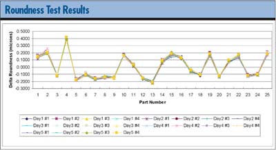

The repeatability of these measurements has proven to be quite good. We can typically achieve a standard deviation of 10 to 30 nm, depending on the parameter being measured. For example, a roundness test of the inside cone for 25 different parts was measured 20 times during a period of five days, as illustrated below. For this set of data, the average standard deviation was 11 nm.
The measurements' accuracy is verified by NIST/PTB-certified artifacts. Corning Tropel has manufactured artifacts for each of the measured parameters: roundness, straightness, parallelism, angle, diameter and runout. Gage studies comparing the measured values to the certified values achieved an accuracy of 40 nm or better for each of these parameters.
