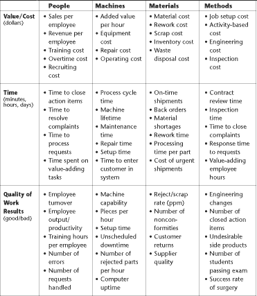

 Table 1 provides a matrix of measurable quality parameters that enable an organization to measure quality. The vertical axis contains three quality aspects: value/cost, time (usually linked to cost of labor) and quality of work results. The horizontal axis represents four major factors--people, machines, materials and methods--from Kaoru Ishikawa's cause-and-effect technique, which quality managers use frequently to analyze problems. Each field includes examples of quality measures available in most organizations; some apply more to production environments, and others relate better to service environments. Most of these meas-ures are available in monetary terms or can easily be assigned a dollar value.
Table 1: Quality-Measurement Parameters

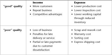

 For it to affect profit, quality must affect either income or expense. How can "good" quality increase income or decrease expense? Or, alternatively, how can "poor" quality decrease income or increase expense? See Table 2 for some examples.
Table 2: Quality's Effect on Income and Expenses
There are many examples that demonstrate how "good" quality can increase income. In most industries, good references from satisfied customers are important factors for business growth. For example, existing customers are more likely to place more orders with an organization that has consistently shipped them defect-free product on time. Quality also has a service aspect for many customers. An organization that is responsive to requests and demonstrates a "can do" attitude will gain competitive advantages. In general, these benefits are obtained over medium- to long-term periods.
 Internal benefits, including cost reductions from improved quality levels, are often achieved much faster. Production costs can be reduced when production processes are streamlined or their effectiveness increased. This can be achieved through improved process control that reduces the undesirable production of bad parts. Shortened machine setup times and immediate availability of complete production information can further improve productivity. Quality professionals have studied valuable improvement techniques that lead to reductions of production cost through quality improvements.
 For example, an injection molding company was able to restructure production by linking three processes that had run independently for years. The average production time was 1.5 days per part from receipt of the order to shipment. Between each process, the company required a components inventory to ensure a short production time, as requested by its customers. After physically linking these processes, the company found that the average production time dropped to three minutes per part. At the same time, the total inventory was reduced by more than $1 million. This example demonstrates how performance improvement and a reduction of working capital were achieved through process improvement.
 Alternatively, many companies keep track of the cost of nonquality. Such costs may include express shipment cost when product is shipped overnight to meet a set delivery date, even if it was an internal problem that delayed production. Furthermore, warranty cost, as well as rework and scrap cost, is often the result of unacceptable quality levels. Quality improvements can lead to immediate cost reductions in these areas.
