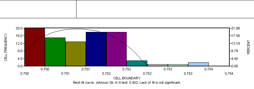

 We now enter the analysis phase of our study. The first step in the analysis is to make a histogram. The histogram for this data set is shown in Figure 1.
Figure 1: Histogram of Teflon Shafts' Outside Diameters
 With a simple inspection, we know we're not dealing with a normal distribution. The normal distribution is symmetrical; it's the famous "bell-shaped curve" that teachers love to talk about. This part of the data set looks more like the uniform distribution up to the value of 0.752, then it shifts to what looks like a uniform distribution with a different mean. This is our first clue that something may be wrong: If our process were stable, we'd see only one distribution. But, in this example, we might see two or more distributions.

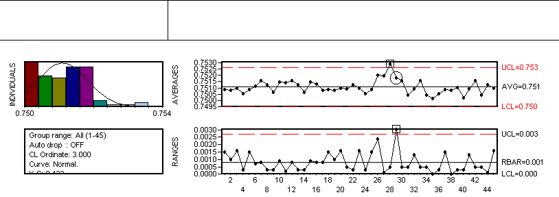

 Because our data isn't normally distributed, it isn't appropriate for us to use an individuals control chart. Instead, we will use an X-bar and R chart. Because we don't have much data, we'll start by using subgroups of two. The X-bar and R chart is shown in Figure 2.
Figure 2: X-Bar and R Chart for Subgroups of Two
 The range chart shows a point outside the control limits at point 29. You would usually stop the analysis at this point--if the range chart is out of control, something is seriously wrong with the process. But because this is an example, let's continue with the analysis. The X-bar chart shows points out of control at points 28 and 29. This confirms the range chart's indication that something is wrong with the process. It's easy to plot another control chart; this time, we'll use subgroups of five.

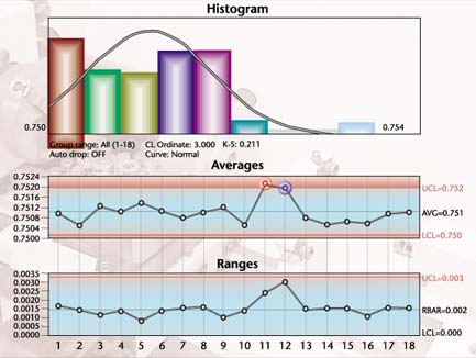

Figure 3: X-bar and R Chart for Subgroups of Five
 Here the range chart is almost out of control at point 12 and the X-bar chart is out of control at points 11 and 12--evidence that something is wrong with the process. Because we're using subgroups of five, these points correspond to data points 55 through 60 in Table 1.
 An out-of-control control chart indicates that the process has changed. Now we know that the points between 55 and 60 are significantly different that the points before and after.
 Our process study enters a new phase. We have to find out why the process changed. One clue is the time at which it changed. Looking at Table 1, we see that point 55 was measured at about 12:30 p.m. We also see that point 52 was .7532. Out control chart tells us that the upper control limit for this process is .752. Point 52 didn't show up as an out-of-control point on the control chart because it was averaged with other readings. But it is unusual. What could have changed? We head out to the production floor and ask the operator, Bill.
