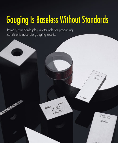

Manufacturers strive to avoid difficult gauging situations by enforcing strict quality control processes that begin with ensuring that their gauges are properly calibrated to international standards of measurement. For best gauging practices, manufacturers start by applying primary standards for measurement and inspection that will ultimately lead to consistent, reliable gauging results. Further, they use proper care and maintenance procedures to maintain accuracy and provide long tool life.
Gauge blocks are key
Precision gauge blocks are the primary standards vital to dimensional quality control in the manufacture of interchangeable parts. These blocks are used for calibrating precision measuring tools and for setting numerous comparative-type gauges used in incoming, production, and final inspection areas. Gauge blocks provide the most economical, accurate method of setting dial test indicators and other gauges used in conjunction with surface plates for inspecting parts with exacting tolerances.
Gauge blocks consist of a hard, stable material with a flat, parallel gauging surface on each side. The measuring surfaces are ground and lapped to an overall dimension with a tolerance of plus or minus a few millionths of an inch. Gauge blocks may be stacked or “wrung” together to form accurate standards of practically any length.
They are made in several grades or degrees of accuracy. Grade 0 is the most popular grade of gauge blocks, as this grade is usually suitable for most applications and offers the best combination of accuracy and cost. Higher-accuracy grades of blocks, such as Grade 00, are primarily used as masters to check other gauge blocks and for applications that require extreme accuracy. Grade B (±50 µin.) blocks are relatively inexpensive but are limited to workshop use where exacting accuracy is not required.
Gauge blocks are available in various materials. For instance, Starrett-Webber’s croblox brand of gauge blocks are made of chromium carbide, which is long-wearing, dimensionally stable, and extremely corrosion-resistant. Croblox gauge blocks will maintain their accuracy many times longer than steel blocks. Croblox gauge blocks are available in B89 Grades 00 and 0.
Another material option is ceramic gauge blocks, which are long-wearing and corrosion-resistant. Ceramic gauge blocks fill the gap between steel and croblox and are available in Grades 00 and 0. These blocks have favorable mechanical and thermal properties that compare the closest to steel of any alternative gauge block material.
Steel is the most economical gauge block material available, and steel’s thermal and mechanical properties are adequate in typical workshop environments. The main disadvantage of steel is its susceptibility to corrosion.
Various styles of gauge blocks are available, including rectangular, square, and heavy duty. The use of gauge blocks can also be extended by means of accessories that can be used with height gauges, snap gauges, scribers, and dividers.
