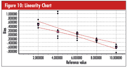

Linearity test
The linearity test is, in a sense, a more elaborate bias test. Multiple reference values (e.g., gauge blocks) are used to see whether bias might vary according to the size of the reference value. In the example in figure 10, below, the device was first calibrated at 6 inches, and then five different reference values of 2, 4, 6, 8, and 10 inches were measured 12 times each. In the linearity chart, we’re looking for four things:
1. Do the various groups of points have a good fit to an imaginary straight line? (Mediocre in this case.)
2. Is the imaginary straight line nearly horizontal with zero slope? (No.)
3. Does the lower curved limit stay below zero bias and the upper curved limit stay above zero bias? (No.)
4. Does the imaginary straight line intercept the vertical axis of the chart (the axis is shown here at the left side of the chart) near zero bias? (No.)
The screen shot in figure 12, below, uses standard statistical limits to confirm that the intercept and slope are too far from zero.
