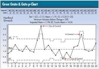

Things are looking up for Simsack, although the problem of jagged control limits that we considered in last month's column continues to plague him--and worry his boss.
DeBote notes that sample 21 would be out of control if the limits hadn't been adjusted, and sample 16 would be considered in control if Simsack hadn't manipulated the control limits. "You can't just move control limits around like pieces of furniture," he tells Simsack. "You've made them fit the outcome you wanted, rather than letting them be set by the data."
Simsack, of course, is speechless--or almost speechless--after his boss's outburst. "This p-chart is based on the binomial theorem," he stammers, remembering that this explanation had worked before. But this time his boss isn't satisfied. "Control limits don't just go up and down on their own like a yo-yo!" he exclaims. Remembering his wife's expression about life's exigencies, Simsack blurts out, "They do if the average is made of ups and downs."

He's correct about the binomial theorem as the basis for the p-chart. But why do control limits become wider when a sample size is small and tighter when the sample size is large? I've illustrated this in the classroom by selecting two students, whom we'll call Arvid and Noah. Arvid is invited to select 20 students randomly and ask them whether they believe the economy is improving. Then Noah does the same, this time with 200 students.
If Arvid asks 20 students and Noah asks 200 students, who would be more accurate? Of course, the more accurate would be Noah because he has more data. This would relate to tighter control limits on a control chart and would mean wider control limits for Arvid. When I ask students which of the two would be more accurate, they respond Noah because he has a much larger sample size than Arvid.
To demonstrate this mathematically, consult the formula for control limits:
If n becomes larger, the control limits become tighter. When n becomes smaller, the opposite is true.
In the example, n-bar , the average sample size, is 1,194. Sample 16 is 2,306, which is more than 25 percent of n¯ , and sample 21 is 392, which is less than 25 percent of n-bar . The readjustment in control limits can be seen on the chart above.
A large sample size renders greater confidence in the sample results; therefore, control limits would be tighter. A sample size of less than 25 percent of the average sample size would generate less confidence in the sample results.
