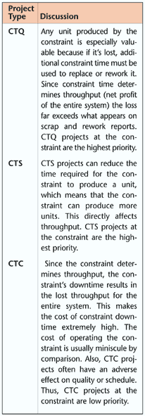

 Assume that you have three Six Sigma candidate projects all focusing on process step C, the constraint. The area addressed is correct, but which project should you pursue first? Assume that one project will improve quality, another cost, and another schedule. Does this new information help? Definitely! Table 1 shows how this information can be used.
Table 1: Throughput Priority of CTx Projects That Affect the Constraint

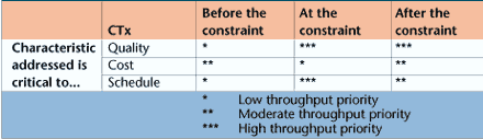

Projects in the same priority group are ranked according to their impact on throughput. The same thought process can be applied to process steps before and after the constraint. The results are shown in Table 2. (Note that Table 2 assumes that projects before the constraint don't result in problems at the constraint.) Remember, impact should be measured in terms of throughput.
 Knowing the project's throughput priority will help you make better project selections among project candidates. Of course, the throughput priority is just one input into the project selection process; other factors--for example, integration with other projects, a regulatory requirement or a better payoff in the long-term--may lead to a different decision.
Table 2: Project Throughput Priority vs. Project Focus
