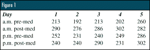

For example, some asthma patients measure their peak exhalation flow rates four times each day: morning before and after medication, and evening before and after medication. The data for one patient is shown in Figure 1.
Now think about what happens when we make each column in the table into a subgroup of size 4. Within each subgroup, we would have the four scores from a single day, and from one subgroup to the next, we would have the day-to-day variation. But the four scores for a single day are collected under different conditions!
The variation within a subgroup is more than just background variation -- it includes both the medication effects and the morning-to-evening swings of the patient. These effects will make the ranges larger than they need to be to characterize the day-to-day variation. As a result of this subgrouping, the limits will be far too wide, and the averages and ranges will hug the central lines. This mistake is called stratification.
What if we made each row of the table into a subgroup of size 5? Now the different conditions would no longer be contained within the subgroups. But what about the variation inside these subgroups? With this arrangement of the data, the day-to-day variation would be within each subgroup. Because the variation within the subgroups is used to construct the limits, this subgrouping will result in limits that make allowance for the day-to-day variation, but do not make any allowance for the variation morning to evening, or before and after medication. This average chart will be "out of control." But did we really need to prove that there is a difference morning to evening and pre-medication to post-medication? Unless we are trying to document these differences, this is an inappropriate subgrouping.

While the data in the table do constitute a time series, they are not easily arranged into rational subgroups because each value is collected under different conditions. In other words, our logical subgroup size is n = 1. You will learn more about the data in the table by plotting them as a time series of 20 values than you ever will by subgrouping them and using an average and range chart.
At the same time, you should resist the temptation to turn this time series of 20 values into an XmR chart. The fact that this time series is a mixture of values collected under different conditions will contaminate the moving ranges and make the limits meaningless.
