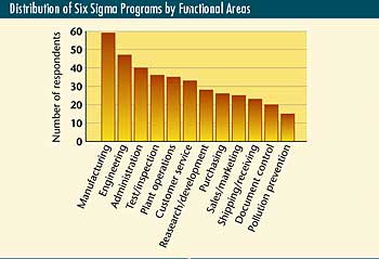

 Given the multitude of Six Sigma articles in the mainstream press and the number of consultants who offer Six Sigma training, one might think that everyone is jumping on board. But among our respondents, only a small number of companies have implemented a formal Six Sigma program, and the vast majority of those are units of large corporations. Of the 280 respondents included in our survey, only 73 have a Six Sigma program in place. Nearly 90 percent of those work for divisions of larger organizations, with 60 percent being part of organizations with more than 10,000 employees. This might be attributable to the methodology having started in a giant corporation, Motorola, and then migrating to other giants, such as GE, AlliedSignal and Texas
Instruments--behemoths benchmarking from each other. But Six Sigma consultants point to more practical reasons that Six Sigma has been embraced largely by big organizations.
 For one, the larger the company and bureaucracy, the more likely are the areas for improvement. "GE had a sea of waste/opportunity," points out Greg Brue, president and CEO of Six Sigma Consultants, which has worked with GE, Tenneco Automotive, AlliedSignal and others. Because Six Sigma methodology is dependent upon identifying concrete areas for improvement that directly affect the bottom line, the more numerous or glaring the problem areas, the easier it is to launch a successful Six Sigma program, he explains.
 Also--and this may be the primary factor--small companies might have a more difficult time effectively implementing Six Sigma, says Thomas Pyzdek, a Quality Digest columnist and Six Sigma consultant. "With Six Sigma, you're asking for a commitment to an infrastructure," he explains. "Black Belts [the work horses of a Six Sigma program] are rotating full-time positions. We say that Black Belts should make up about 1 percent of a company's employment; of course, the company works up to this. But, by virtue of the fact that Six Sigma requires this sort of commitment, small businesses would have a hard time doing it." Pyzdek estimates that companies with fewer than 500 employees would struggle with implementation.
 "You need the critical mass [afforded by a large company] to assign that type of full-time personnel," agrees John Kullmann, director of marketing at Six Sigma Qualtec, one of the original two firms to spin off of Motorola's Six Sigma program. And although it's not impossible for a small company to do this,
Kullmann adds that companies with fewer than 500 employees would certainly have to use a different approach. "Traditionally, a company dedicates people for the Six Sigma program," says Kullmann. "At a smaller company, those responsible for implementing Six Sigma might have to do so as an adjunct to their current duties--Six Sigma becomes just another hat they wear."
Slow adoption
 Although the Six Sigma methodology has been around for 15 years or so, almost two-thirds (62%) of our surveyed companies that have been using Six Sigma have been doing so for less than two years. This figure might not be surprising. Six Sigma, which was indeed a topic of discussion among quality professionals well before, didn't receive serious publicity until GE's Welch made headlines in 1998 with reports of his company's $350 million in Six Sigma-related savings.
 "As more and more began to see the results at GE, other companies began to adopt it," explains Kullmann. "Although GE wasn't the first firm to adopt Six Sigma, it was the most visible." Once GE reported millions of dollars (which later grew into more than $1 billion) in Six Sigma-related savings, it didn't take long for other large companies to take up the Six Sigma torch.
