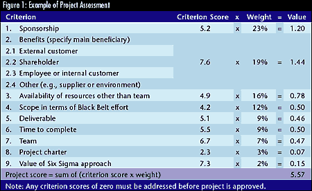

 Figure 1 shows a set of criteria for assessing a Six Sigma project, along with weights for each criterion. The weights are simply my own subjective assessment of the importance of each criterion. I arrived at these weights using a software package called Expert Choice, which I've found to be very useful in converting subjective assessments to numerical values. Expert Choice uses the analytic hierarchical process method to convert pairwise comparisons to weights that add to 100 percent. These weights can be used in various decision matrixes, such as the one shown in Figure 1, or in quality function deployment.
Figure 1 is used by assigning a score of zero to nine to each criterion. The criterion scores are then multiplied by the weights and added together to get a total score for the project. Project scores can range from zero to nine. Keep in mind that the numeric project score isn't as important as how it compares to other project scores. Ideally there will be a point where some projects are clearly better than others, allowing Black Belts to pursue those projects.
 To use Figure 1, you need to develop guidelines for assigning scores to each criterion. The guidelines just need to make sense for you and your organization. The numerical scale need not be zero to nine; however, I recommend using the same numerical scale for every criterion. Using a different numerical scale amounts to changing the weights. Figure 2 presents an example of how guidelines might look.
This approach borrows elements from QFD and decision making. It isn't perfect, but it will serve the purpose of distinguishing good prospects from real duds. The inevitable projects remaining in the gray area can be examined more closely once the cherries have been picked. But by that time, there are usually more cherries on the tree.
