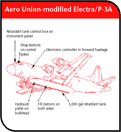

 Now, however, Blawat is stationed on a new front. He works for Aero Union's Airborne Systems Development Group, which specializes in converting used military or commercial aircraft into aerial firefighting machines by designing, manufacturing and installing fire-retardant delivery systems.

 A major thrust of this preliminary engineering research is determining which systems (e.g., hydraulic systems, noise, electrical, aerodynamics, and weight and balance) of the aircraft to be modified will be affected by the add-on system. "Then you're ready to call the FAA and schedule a kickoff meeting," Blawat explains.
 At such a meeting, FAA experts in a variety of aviation systems work with the company to develop project-specific certification and conformity plans, which serve as roadmaps for completing the project. It's within the certification plan that any initial FAA concerns, and required steps for addressing them, are spelled out. "If, for instance, an FAA official believes our modification would strain the plane's hydraulic system, a schedule is included for testing and submitting additional engineering data to the FAA for approval," explains Blawat.
