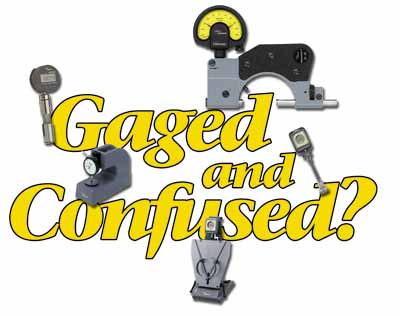

Answer these 12 questions to chase away your gage-selection blues.
by George Schuetz
Once you've decided that you need a gage to measure the parts your company is producing, a well-defined selection process will help you narrow down the many possibilities to the one that is right for your application. But to avoid unnecessary expenditure, first determine whether a gage meets your needs better than a less expensive hand tool.
 Hand tools, such as micrometers or calipers, are usually better suited for general-purpose applications. They typically have a broader measurement range but coarser resolution. Measurement tasks also take longer to perform with hand tools, which are designed for individual measurements of many different parts rather than high-volume measurements of a narrow range of parts. And because they can be used in so many ways, hand tools generally also require more skill on the part of the user.
 Conversely, gages are the best choice for measuring a unique part with close tolerances that will be manufactured and checked in high volumes. The gage allows the operator to simply snap the part in place, collect the relevant data with high accuracy and quickly move on to the next task, fulfilling the need for accuracy and productivity.
 Deciding whether you need a gage is the easy part. Once you have decided in favor of a gage, though, it's easier still to find yourself caught in a bewildering quagmire of choices. For example, a simple outside diameter might be measured by any one of the following gage setups, ranging in price from $150 to $150,000:
  A go/no-go snap gage
  A dial indicator on a simple stand
  A benchtop inside diameter/outside diameter comparator
  An air-ring gage
  A custom-built fixture gage with electronic probes
  An engineered gage with fully automated parts handling and sorting by size categories that provide compensation feedback to the machine tool
 This type of thinking can make you crazy, so don't even let it begin. Instead, walk through the gage selection process by answering the following 12 questions.
