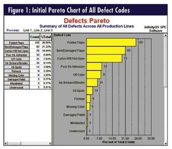

The back-door data-collection plan allowed management to view the frequency of the defect codes on a single chart (as seen in figure 1 at the upper left). Surprisingly, the resulting Pareto chart indicated that the most common defects weren't cosmetic or print-related. Instead, most carton defects proved to be folded, bent or damaged carton flaps.
When encountered at Plant A's customers' sites, functional defects can jam carton-filling equipment and force expensive machine downtime. Not only were machine shutdowns exasperating for its customers, Plant A's expenses were affected as well, due to customer credits and returns. The company's management knew that to reach the plant's goal of becoming "nameless" to its customers, it needed to stop defects from reaching customers and prevent defects from occurring in the first place.

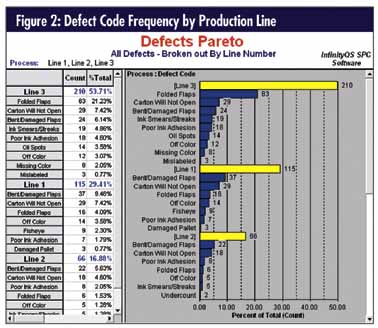

While performing back-door data collection, inspectors noted not just the defect code but the production line from which it originated. To identify specific actions that could be taken at each line to reduce defects, they created a multilevel Pareto chart (as seen in figure 2 on page 31). This type of Pareto chart displays the identical defects found in figure 1 but sorts them by production line. Each line's defects are summarized and displayed in a yellow bar, while the blue bars illustrate frequency and type of defects. The overall result is a Pareto chart within a Pareto chart.
In figure 2, each line's specific defect codes helped management allocate improvement resources and identify unique changes to each line that would reduce the plant's overall functional defects.

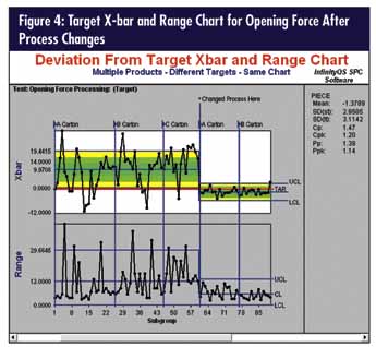

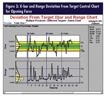

To understand how folder-gluers were performing, a "deviation from target" control chart was used to evaluate opening force. Although each product may have different opening-force specifications, the chart is normalized to accommodate unique customer tar--get values. The chart allows statistical control of the process, regardless of the cartons being manufactured.
After incorporating the deviation-from-target control chart, operators and quality managers found that opening force varied dramatically over time, from one job to the next and from shift to shift (as seen in figure 3). This resulted in numerous statistical alarms on both the X-bar and range charts. Additionally, the average opening force was almost always greater than the customer target values, represented by a red horizontal line on the X-bar chart. After working with engineers and operators, the plant instituted changes to reduce the average opening force. It instituted procedures to minimize differences between shifts, jobs and other process variables. The result was significantly less opening-force variation and average values much closer to customer targets (as seen in figure 4). In a very short time, customer complaints about opening force were virtually eliminated.
Additionally, Plant A's customers were able to use a single, simplified setup of filling machines, reducing complexity and setup time.

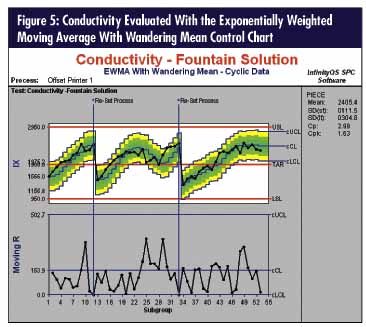

Plant A's operators needed to attack the pH of the fountain solution and conductivity at the printer. If these two critical parameters aren't precisely controlled, they can lead to scumming, which in turn creates print defects. Operators periodically take a fountain solution sample, check pH and conductivity, and record results on control charts. To evaluate pH, they plot data values and analyze them on an individual X and moving-range control chart. To apply a control chart to conductivity was more challenging. Because conductivity is naturally cyclical, a standard control chart with linear control limits couldn't be applied. Plant A's operators needed a tool that would model the natural tendency for conductivity values to slowly increase over time. They chose the exponentially weighted moving average (EWMA) control chart with wandering mean. This specialized chart is particularly useful for tracking chemical processes, tool wear or any situation where data values are expected to gradually increase or decrease over time, rather than adhere to a linear data model.
The EWMA chart incorporates a "next step predictor" based on previous subgroups of data. If previous plot points increase incrementally, then the EWMA chart predicts the next value based on historical data. Using this prediction, control limits change and create a "stepped" appearance, such as the one exhibited by the control chart in figure 5.
The EWMA control chart with wandering mean helped operators assess the control of individual subgroup values while simultaneously determining when to reset the fountain solution before it exceeded specification limits. By more closely controlling both pH and conductivity, print operators were able to control and reduce scumming, which resulted in a significant drop in print-related defects.
