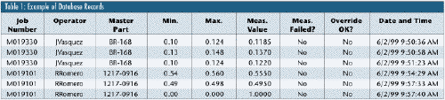

At Parker Hannifin's Tucson, Arizona, facility (Partek), we use a Visual Basic program to input our inspection data into shop-floor computers. The screen shows the part number being inspected, and the computer prompts the operators to look for visual defects and instructs them on which dimensions to measure. For many dimensions, operators can use digital micrometers or calipers to check the parts and then simply press a button to enter the measurement. The data is transmitted to a computer using a GageTalker. All relevant information is then sent to a Microsoft Access database (see Table 1). Palo Verde Software wrote the code in Visual Basic and worked with us to develop the screen layouts. Because the software development company is local, the wizards at Palo Verde have been able to customize and further refine the program as we gained experience with it.
 The table shows only about a third of the data in each line of the database, because the database pages are too wide to present in this format. Columns one, two and three are self-explanatory. Columns four and five show specification limits, and column six is the actual measurement the operators got when the parts were checked. Column seven is titled "Measurement Failed?" The first thing I do every morning is check that column to see if we made any parts out of specification. If any parts were reported out of tolerance, I make sure they went to the material review board (MRB). If production wants to continue the job run while the parts are out of specification (as when, for example, the problem is in the process of being corrected), they must get permission from an authorized person. That person must approve the override and indicate so in column eight. Column nine is a date/time stamp that gives us a clear record of when specific events took place.
 One of the things we learned from our MRB records (also in a database) is that our design engineers often over-specify some of our part dimensions. The corrective action in those cases is simply to open up the tolerance. At other times, we have to make process changes to bring the parts into specification.
 Just glancing at our database records gives us a good picture of what part was made, who made it, when he or she made it and how well we can hold the tolerance. When I give customers the plant tour, I show them our database and how carefully we keep track of everything. It gives them a lot of confidence to know we are on top of our processes, and it helps our marketing department sell our products.
