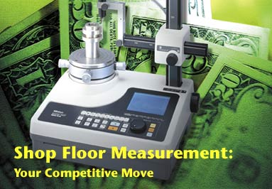

 For instance, at less than $10,000, the Mitutoyo RA114 Roundtest is the least expensive roundness-measuring instrument in its class. It's easy to use, and it handles 99 percent of the shop floor roundness measurements required on today's part prints. The unit has a built-in printer and RS-232 port for connectivity. The enhanced, automatable RA116 includes a PC with software able to store historical data for the operation and highlight trends.

  Roundness . For most two-axis work, the RA114 and RA116 described previously are more than adequate for work piece diameters up to 16.6 inches. Both measure roundness, concentricity, co-axiality, circular runout, squareness, thickness deviation, flatness, and parallelism and give roundness results in least square circle (LSC), minimum zone circle (MZC), maximum inscribed circle (MIC) and minimum circumscribed circle (MCC) references. That covers 99 percent of the part-specification requirements seen today. The RA114 is manual, has a built-in printer and is networkable. The fully programmable RA116 includes a PC in place of the built-in printer to store and analyze historical data as well as report the result at hand.
 For three-axis work, particularly cylindricity, it's necessary to spend more. For about $44,000, the fully programmable model 426 unit also handles symmetry, standard and spiral cylindricity, runout, and total indicated runout (TIR). In effect, it's a polar CMM. A digital adjustment table speeds and simplifies work piece centering and leveling for higher throughput.
