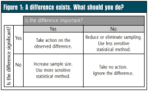

 Significance is a technical term when used in statistical science. It has a precise meaning as determined by the statistical test being applied. While not advisable, it's possible to determine statistical significance without knowing what the numbers mean or how the results will be used. Importance, on the other hand, is a nontechnical term. The questions being answered are implicit: Important to whom? Important for what purpose? Unlike analyzing statistical significance, pat answers can't be given in advance regarding a particular number's importance.  It's important to think before reacting to an observed difference, whether it's significant or not. Figure 1 provides some useful guidelines for the thinking process. About the author Thomas Pyzdek is president and CEO of Pyzdek Management Inc. Comments can be e-mailed to him at Tom Pyzdek . |
