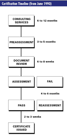

The ISO 9000 certification process is not complex, but it can take up to 18 months to complete.
The first step in the certification process after a manufacturer has confirmed that its quality management systems are in place and has implemented the requirements of ISO 9000 is to contact an independent organization, known as a certification body. The organization selected submits a formal price proposal and checks the manufacturer's quality management system against the appropriate ISO 9000 standard.
JW : Actually the first step is to clearly understand, at the very highest levels of management, why the organization should achieve compliance and certification to ISO 9001. Often the most important reasons relate not to meeting customer or regulatory demands for certification but rather to improve the processes of the business. In my experience, failure to clearly understand the answer to the "why" question is the most significant cause of system problems, including problems with certification and, later, problems with system efficiency and effectiveness. Without a clear understanding of what they want and need from the system, top managers eventually tend to get frustrated.
Upon agreement of the appropriate ISO 9000 standard, scope of assessment and fee proposed, the manufacturer files a formal application and the assessment program begins. The certification body provides a Quality System Supplement (QSS) to the manufacturer as a guide and reference. The QSS explains how ISO 9000 applies to each process of the quality management system. ISO 9004 establishes guidelines for the implementation of ISO 9001, 9002 and 9003. From the time the manufacturer expresses an interest in ISO 9000 certification, the process can take one and one-half to three months.
The certification body determines the manufacturer's readiness to be assessed by reviewing the quality assurance manual and procedures, prepares the corresponding assessment program, and reviews the manufacturer's quality management system on the plant site against the selected ISO 9000 standard to be assessed. This phase takes between six to nine months.
Assessment teams are selected on the basis of the type and complexity of the product and company under assessment. The number of man-hours involved in an assessment is related to the size of the company, complexity of product and ISO 9000 standard required. The findings of the assessment are documented in Non-Compliance Notes, which are graded in two categories:
• Hold-point noncompliances, which must be cleared before approval is granted. This extends the certification process four to six months.
• Ongoing-system-improvements non-compliances, which do not preclude the awarding of a certificate. The completed process takes approximately 16 months.
In the likely event (there is a 70-percent system failure rate documented) that the manufacturer must take corrective action, the certification time can be extended four to six months. A noncompliant system that has been corrected must be maintained for a period of four to six months prior to certification.

 Comments on certification timeline
DR : Three factors have significantly influenced this timeline. First, global commerce has made control of core processes an indisputable minimum requirement for playing in most markets. In the past, documentation and control of business practices, requirements and critical processes had been inconsistent and sporadic. An ISO 9001 project, therefore, required more time since the QMS was being built from the ground up. That situation is less likely to be the case today.
JW : Management of key processes became mandatory where I was working in the early 1980s. In fact, the 1987 version of 9001 can be roundly criticized for not adopting the "process approach" at the initial stages. With the 1994 version, process became more of a 9001 issue and, of course, the 2000 version adopted the process approach as an alternative to the more bureaucratic "procedure approach." It took a while, in my view, for the standards to catch up with the prevalent thinking of the benchmark organizations.
DR : Second, the awareness of ISO 9001 and other QMS models, such as ISO/TS 16949, ISO 13485, etc., as well as the development and availability of quality tools, has decreased the likelihood that anyone would approach an implementation process with babe-in-the-woods naiveté. People have become better educated simply because utilization of QMS models has become more pervasive.
Third, ISO 9001:2000 de-emphasized the need for "documented procedures," thus making it easier for organizations to utilize the documentation they already had in place as the basis for their QMS. Much of the time spent on earlier implementation projects involved ensuring the development of compliant documentation.
JW : The adoption of the process approach in the 2000 version means that organizations should be spending less time writing down what they do and more time analyzing and managing the processes important for success. Unfortunately, we still see way too much emphasis on documentation and too little work on process improvement.
