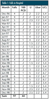

Spc1Not quite everything, I thought to myself as I recalled the event earlier that day. Probably anything that caused an injury. Only part of the story, but worth looking at in any event. The hospital faxed me the data on falls (see Table 1).
All organizations keep such data. However, it's in a form that's seldom used. The data contains information, but not in a format that people can easily interpret. To help us glean some knowledge from this data, let's consider three statistical process control tools: the histogram, run chart and control chart.
A histogram shows the empirical distribution of the falls data. It would show that the number of falls reported each month varies from zero to six, with four falls per month being the most common. The number of falls appears to be fairly consistent; no months contain a great number of falls.

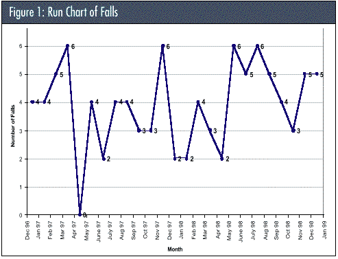

Where the histogram is a snapshot, the run chart is a movie. In Figure 1 we see the falls data stretched out over time. Applying statistical tests produces no significant data patterns. The run chart helps put the data in a context, which helps prevent misconceptions caused by looking only at a portion of the data.

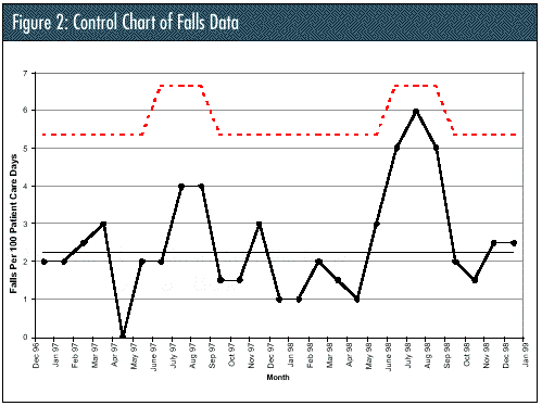

While run charts allow us to examine patterns, they are less helpful in analyzing outliers or freak values. Control charts provide control limits that help do this. Creating a control chart of the falls data requires first determining the number of patient care days (PCDs) for the hospital each month. After all, one way to reduce falls to zero is to admit no patients! The U chart in Figure 2 shows reported falls per 100 PCDs. It also includes a centerline showing the process average and an upper control limit on the number of falls per 1,000 PCDs. Note that the UCL rises and falls as the number of PCDs changes.

The control chart shows that the rate of falls is "in control." This means that if nothing is done each month, the hospital can expect to average about two serious falls per 100 PCDs. Some months no people will fall and hurt themselves, other months a half-dozen or more injuries might occur. That is, unless someone takes the time to look into the reasons why people fall. When management decides to do that, a whole host of techniques can be brought to bear on the problem, such as cause-and-effect diagrams and Pareto analysis.
