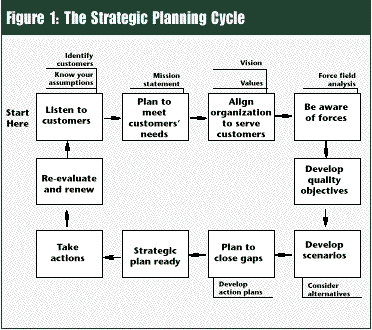

Several broad steps comprise the strategic planning process for any organization (see Figure 1). The process always begins with the customers in mind: who these customers are, what they want and what trends will impact them in the future.
Having established the customers� perspective, an organization must determine where it should be in relation to its customers. Should it keep the same ones? Expand into new customer areas? Give up, maintain or expand market positions? Quality should be a major factor in answering these questions. A successful organization will focus on its areas of excellence, where it provides high-quality service and products to customers in the most profitable manner. Endeavors where quality is low, scrap costs are high or customers have complaints must either be targeted for change or abandoned as untenable.
When an organization has clarified its position regarding its customers, it should next work on internal vision. An organization�s structure may need to change in order to achieve the desired outcome. At this time, the organization�s planners also must attend to the trends and future conditions that will impact the organization. Depending upon the organization�s mission, demographic studies, long-term economic forecasts, technical projections and a quick review of the company�s history all can help assess the future.
Once the planners envision what the organization will become, they must identify where the organization is in relation to where it wants to be. Planners then should determine the specific steps required to get there. This often becomes the hardest part of the planning process. Numerous day-to-day forces will divert attention and resources away from the strategic plan. Ingrained behaviors must be resisted in order to take new steps toward achieving the vision.
Implementing the steps in the plan means taking action and assessing its effectiveness. Undoubtedly, any change will meet with resistance, which must be overcome. Periodic reassessments of the strategic plan will be necessary to ensure the vision is still accurate. As demonstrated in Figure 1, the strategic planning process becomes a cycle within the organization.
