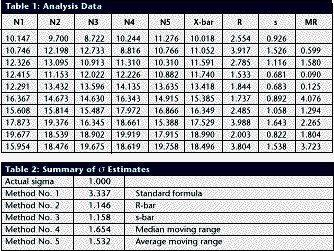

For the purpose of discussion, I invented a data set to analyze, as shown in Table 1. The data reflects a process that starts with an average of 10. The process is influenced by a special cause that makes the average increase by 1 every hour. The standard deviation remains constant at 1, and the data follow a normal distribution.

Shewhart showed that this traditional estimate of s is only valid when the process is stable. If a process is influenced by a special cause, then this estimate will overestimate the process scatter. For our example, the formula estimates s as 3.337, far greater than the actual value of 1. The difference is due to the trend created by the special cause. Because the estimate includes variation from the special cause, detecting the special cause is harder to do. The 3-sigma limits from this estimate are 4.446 and 24.468, which include all of     the data.

With these �clean� subgroups, we can estimate the process dispersion for each subgroup, then combine the results to find the overall estimate of s. One way to estimate dispersion is to find the range, R, by subtracting the smallest observation in the subgroup from the largest. After doing this, we can average the R values and use a correction factor, d2, to find s. For subgroups of 5, the d2 factor is 2.326; for our data, the average range is 2.665. This gives s = 1.146, which is much closer to 1.0.

Method 3 works by finding the subgroup s values, then averaging them to get s and dividing this by the bias-correction  factor c4. Subgroup s values are computed using the formula shown in method 1 for each subgroup separately. Obviously, this is more tedious than finding the range for each subgroup. With method 3, we get an estimate of s = 1.158 for our data.

If it isn�t possible or desirable to collect data in subgroups, we can correct for special causes by finding the range between consecutive hourly samples. To get s, we must multiply the median moving range, , by the correction factor 1.047. For our data, we get s = 1.654. The estimate is somewhat larger than the estimates we obtained from subgrouped data because the moving ranges don�t completely factor out the differences between the subgroup. However, the estimate is closer to the correct value than the s value found with method No. 1. Recent research suggests that this approach gives good results for a wide variety of out-of-control patterns.

This method for estimating s is based on the average moving range, . Doing this for the sample data set gives s = 1.532. Because it�s also based on the moving range, this estimate suffers from the same shortcomings as method No. 4.
Table 2 summarizes the results of all of these methods. The least accurate result is found when the standard formula is used. For SPC work, this formula should only be used when a control chart shows good statistical control. Despite the fact that, for our example, the result was slightly more accurate than the estimate, the best formula from a statistical perspective is method No. 3. For subgroups of five, the advantage isn�t all that great, but it becomes greater as the subgroup size increases. The method usually comes in second to the method, unless the statistical advantage is outweighed by some practical concern -- such as ease of understanding.
The moving range methods, while inferior to the subgroup methods, are far better than the standard s formula. Generally speaking, the median moving range estimate gets the nod over the average moving range estimate.
