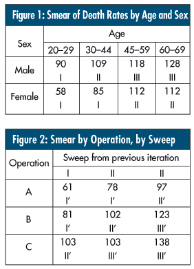

• Summarize data in large tables before analysis. When there are many categories of covariates, you may end up with tables containing hundreds or thousands of cells. If many of these cells contain no data, the table is said to be sparsely populated. One way to deal with this is to apply an approach called "smear and sweep." Smearing involves selecting a pair of classification variables and creating a two-way table from them. The values in the table are then swept into categories according to their ordering on the criterion variable.
Figure 1 shows an example of smearing death rates per 100,000 operations for a sample classified by age and sex, which are confounding variables. The sweeping is performed by creating a new category based on similar death rates, shown as Roman numerals. In this case, similar death rates across all ages and sex are reduced to three groups: I, II and III. These groups could be classified as "age/sex."
Figure 2 shows how the age/sex sweep variable is smeared with the new confounding variable "operation type" to create new sweep variables, I´, II´, III´. At this point the new sweep variable reflects the effects of the three confounding variables of age, sex and operation type. The process continues until all confounding variables are accounted for. If done properly (a lot of judgment is involved in selecting the cutoffs for the sweep variables) the smear- and-sweep method will produce less biased results than ignoring confounding variables. Some simulation studies show that bias may result from the application of smear and sweep, however.
