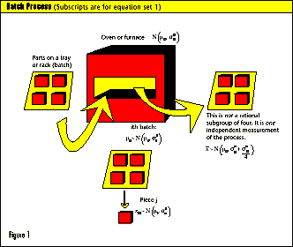

Consider a heat treatment process for metal parts or for plastic or rubber productsfor example, polymer curing. A properly functioning oven or furnace will subject all the pieces in a batch to the same temperature for the same time. Unavoidable random temperature fluctuations within the furnace causes within-batch variation. Random differences between the conditions for each batch also will occur. Thus there are two variance components: within run and between run.

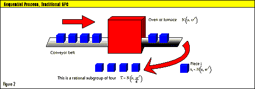

The rational subgroup should be a random sample of the process�s overall performance. A sample of four pieces from a batch is not a sample of the overall process; it�s a sample of one batch and reflects only the within-batch variation, or batch uniformity. A batch or run, not a single part, counts as one independent measurement of the overall process (see Figure 1). If, however, the pieces go through a furnace on a conveyor belt, each piece is an independent measurement of the overall process (see Figure 2). N(u, sigma-squared) means �normal distribution with mean u and variance sigma-squared.� Under these conditions, traditional SPC should work properly.
Statistical model for a batch process
Here is the model for a batch process with only one level of nesting. The ith batch�s mean, u-subi is a random sample from the overall process. Pieces from the ith batch, x-subij, are then random observations from this batch.

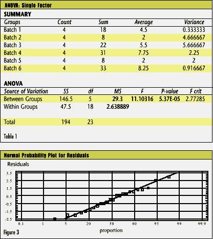

Let�s look at Wheeler�s data and assume that each subgroup is a batch:
     Table 1 shows the output from Microsoft Excel�s one-way ANOVA tool. (Corel Quattro Pro and Lotus have similar capabilities.) Pay close attention to the highlighted numbers. The F test shows significant between-batch variation; it rejects the null hypothesis that the batches have identical means. Next, use MSE (within groups) and MST (between groups) to find the variance components:
and the correct limits for the averages chart are 5.00 ± 3 ¥ 2.706 = [-3.12, 13.12]. Although these limits look incorrect on an average chart, for a batch process with nested variation sources, they are correct. This is because the subgroups of four aren�t really what they appear to be. One batch is one independent representation of a batch process. We really have an individuals chart with six data points, not an chart with six subgroups of four.

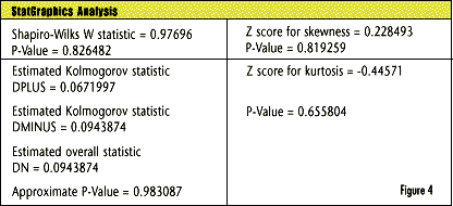

Practitioners must always assess statistical models for conformance to the underlying assumptions. If the one-way ANOVA analysis is suitable for this data set, the model�s residuals (i.e., the observed minus expected values) should follow a normal distribution. Following are some tests from StatGraphics by Manugistics. (With only 24 data, the chi square test for goodness of fit cannot be performed.) The residuals should form a straight line on a normal probability plot (see Figure 3). Figure 4 represents the StatGraphics analysis. Note that none of the tests come close to rejecting the normality assumption for the residuals.
