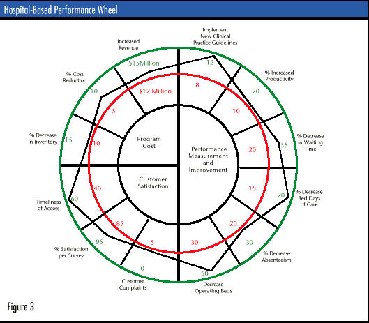

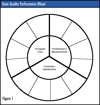

Quality performance wheels can be used to monitor and improve virtually any aspect of a health care delivery program or system. Figure 1 shows the basic performance wheel. The outer ring indicates the performance goal while the middle ring indicates minimum acceptable performance. This format can be used to develop performance goals for any quality management performance measurement and improvement consideration. Three key elements -- performance measurement, program cost and customer satisfaction -- represent the core for all programs.
The object of the performance wheel is to move measurement goals from the minimum acceptable ring to the outer or performance goal ring, forming a perfect circle. The process is continuous because new goals can then be set that improve on past performance.
The wheel displays system performance measures in relation to performance, which allows a balanced, comprehensive view of an organization's progress toward predetermined goals. These performance measures represent the top tier in a series of strategically important but increasingly specific documentation of process and outcome at the core process, department, work unit and individual levels.

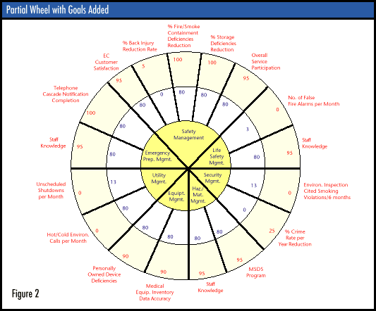

The performance wheel in Figure 2 shows measured and documented results of a recent survey and performance report for the JCAHO Environment of Care Standard. The inner circle includes seven key elements. Goals and minimum acceptable performance levels have been established. At least two target performance measures have been established for each of the seven key elements and are listed outside the outer ring. Figure 3 shows a hospital-based program.

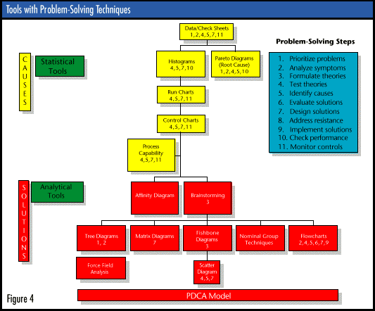

Statistical tools primarily identify causes of problems or situations. Analytical tools analyze and identify possible solutions to problems or situations that, for whatever reason, need to be corrected, changed or modified.
Frequently the question arises over which tool is best suited to identify and solve a particular problem. Figure 4 shows 11 generally accepted steps of problem solving. The accompanying chart is then modified by adding the number for the appropriate step to the most appropriate statistical or analytical toolbox. Often, one of the tools can be used for problem solving and decision making. These analytical shortcuts have proved quite effective in the rapid but precise methodology of applied statistics in health care.

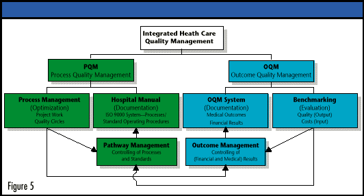

Integrated health care quality management
Figure 5 shows a quality management model for implementing ISO 9000. The model’s primary purpose takes into consideration both the process and outcome aspects of health care. Payers are beginning to show a preference for working with health care providers that provide information on process, or more specifically, the quality of treatment provided. For institutional and managed care providers, process is where most quality achievements can occur. Clinicians and direct health care providers, on the other hand, more often are concerned with outcomes. Strong support is growing on both sides to find ways to improve both process and outcome without compromising either.
The integrated health care quality management model depicts a method for implementing ISO 9000 as both process quality management and outcome quality management. Both sides share the fundamental reasons for more quality management in health care, which are:
