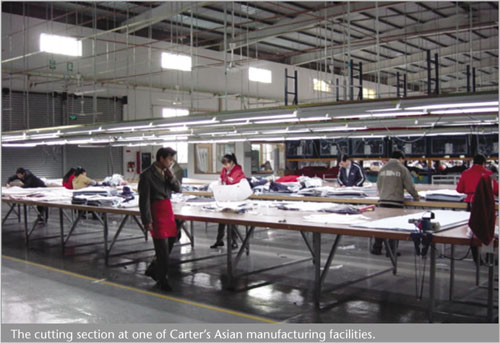

Who isn’t familiar with Carter’s infant sleep and playwear, or children’s underwear and sleepwear? Like so many apparel companies, during the late 1990s Carter’s moved from domestic production in its own factories to hiring out much of its manufacturing to separate companies, according to Steve Loftin, vice president of quality assurance at Carter’s Atlanta headquarters.
It’s a switch from “internal manufacturing” to “full-package sourcing,” says Loftin. “That means we buy the completed product to be shipped from their factory direct to our distribution centers. All is done to our specifications.” The fact that the third-party manufacturers are based in locales ranging from South America to Thailand and Indonesia “brings on a whole set of challenges and difficulties,” he says. “It’s not easy, but it’s definitely worth it. We get good, quality product, and, with proper planning, we get the product in on time.”
Quality issues Carter’s faces range from color quality and dyes to fabrics. As much as possible, colors can’t be allowed to run, and fabrics can’t be allowed to shrink. All of these processes—and more—require extensive premanufacturing testing and reporting from locations thousands of miles from Carter’s home base. Of course, the final product must reflect the company’s exacting stand-ards that have made it a well-known and respected brand name.
Like many in the apparel industry Carter’s focuses on conformity assessment or product testing, and has evolved its own quality processes based on total quality management principles that are codified in its quality manual. Moreover, its factories must pass social compliance audits to ensure that employees are treated fairly.
Besides relying on the interface between its home-based quality team and agents located in foreign countries, Carter’s hires third-party laboratories around the world to perform tests throughout the manufacturing process. Quoting the late President Ronald Reagan, Loftin says Carter’s quality catchphrase is, “Trust, but verify.”
“We put trust in our agents and trust in our factories, but we verify that our expectations are being met by on-site visits to the factories, by inspection of the product as it arrives at our distribution centers and then through random testing,” he explains. “There’s a constant interface between Carter’s and our [overseas] agents. We have several minor and at least two major meetings annually, and agents undergo quality assurance training in the United States.”
