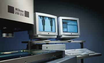

In some ways, video imaging offers the best features of both toolmakers' microscopes and optical comparators. Video-based measuring systems are becoming increasingly prevalent in government and industry, and may one day serve as the standard for taking measurements.
Video measuring equipment includes stable, heavy-duty stands and video monitors for easily viewing parts. With their excellent online documentation and archiving capabilities, repeatability, and image-processing and manipulation capacities, video-based systems offer extraordinary flexibility.
A fully automated video measuring workstation will create a workpiece coordinate system, adapt parts to their varying orientations, import and export files, and take advantage of computer capabilities such as dynamic data exchange. High-end units provide profile, through-the-lens and oblique illumination as standard features and can operate in manual, semiautomated or fully automated modes.
Video offers other advantages as well. For instance, it can be used not only for measuring but for inspection, teaching and documentation. Also, because users look at monitors, these systems are comfortable to use over long periods of time. Finally, they can include a graphical part display -- a "road map" for measuring sequences.
