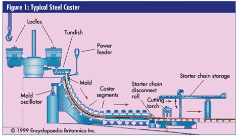

A steel caster allows molten steel to be poured into the top of a mold and to be continuously cast as a long slab of steel out the bottom of the mold, much like when you extrude children's modeling clay out of a press in the form of a square. To say casters and their components are huge is an understatement. Figure 1 below shows a simple drawing of a caster. To get an idea of the size, each of the nine caster segments is about the size of two SUVs stacked on top of each other. Each of these components needs to be aligned within a few thousandths of an inch.
Recently, at an older mill, Falk helped mill operators dramatically reduce downtime during an outage. Working on the mill floor, engineers positioned their laser tracker in the caster and ran the instrument's calibration routine, which takes about five minutes. Then they began collecting data on the caster bow frame, which has a radius of approximately 50 feet. If the owner had been using optical measuring equipment, the survey would have taken anywhere from one-and-one-half to three days. Using a laser tracker, Falk technicians collected the needed measurements in less than two hours.
The results of an earlier survey using optical measurement techniques had been a little unsettling. According to the optical survey results for the caster, all 36 of the bearing pads on which the nine segments sit in the bow frame needed to be adjusted. This is where experience and the versatility of the laser system came into play. Using the laser tracker, Falk engineers showed that only 24 of the 36 bearing pads needed adjustment. Falk engineers took this reduction one step further. Using a "best fit" alignment for the equipment, only seven of the bearing pads had to be adjusted.
"This way, they avoided having to re-shim 29 bearing pads and cut several hours off the outage," says Falk.
