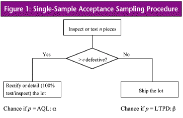

 Two numbers define single-sample attribute sampling plans: the sample size, n, and the acceptance number, c. The inspector (or test) examines n pieces, and the lot passes if c or fewer are nonconforming. More than c nonconformances results in rejection of the lot. Such lots are usually rectified or detailed: All the pieces are tested or inspected, and the bad ones are discarded (Figure 1). p is the lot's actual nonconforming fraction. The sampling plan must meet two specifications: The chance of failing a lot of acceptable quality (acceptable quality level or AQL) must be no greater than a, which is the producer's risk, that is, the manufacturer's risk of having to reject an acceptable lot. The chance of accepting a lot of rejectable quality (lot tolerance percent defective or LTPD) must be no greater than b, which is the consumer's risk, that is, the customer's risk of getting an unacceptable lot. Many plans will meet or exceed the requirements PA(AQL) ³ 1 - a and PA(LTPD) £ b, where PA is the probability of acceptance. Since inspection and testing cost money, the best plan meets these requirements with the smallest possible sample size. An algorithm for finding the most economical sampling plan follows. Sampling plan economics To determine the plan's economic aspects, the planner must know the per-unit inspection cost and the per-unit failure cost. The inspection cost can include the cost of purchasing new inspection or test equipment--existing equipment is a sunk cost even if the accounting system applies its cost to the product under consideration. The failure cost, or penalty cost, is the cost of shipping bad pieces to the next operation. In Harris' application, this is the cost of assembling these units into complete transistor packages before testing and discarding them. The inspection cost is proportional to the plan's average total inspection (ATI), and its penalty cost is proportional to the average outgoing quality (AOQ). Procedure The procedure assumes that the sample is a small portion of the lot, i.e., the binomial approximation to the hypergeometric distribution applies. (The procedure could presumably be modified to use the hypergeometric distribution.) Under the binomial distribution,

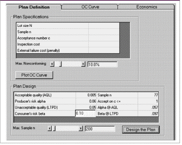

 The algorithm's goal is to find the smallest n for which PA(noptimal,coptimal,AQL) ³ 1 - a PA(noptimal,coptimal,LTPD) £ b.
 Example

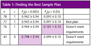

 Juran's example uses a sample plan with n = 78, c = 1 to develop an operating characteristic curve, and this example works the problem in reverse. For n = 78, the acceptance probability at p = 0.005 is PA = 0.99578 (the chance of getting no bad pieces)  = 0.9415 So a = 0.0585 £ 0.06. The acceptance probability at p = 0.05 is 0.0934 £ 0.10, so n = 78, c = 1 meets the plan requirements. The alpha risk goes down as the sample gets smaller, so a sample of 77 (which yields a consumer's risk of 0.097 £ 0.10) is still capable of meeting the consumer's risk requirement. But for n = 76, b rises to 0.101 > 0.10. The program has therefore found the smallest sample size that fulfills the plan specifications (Table 1).

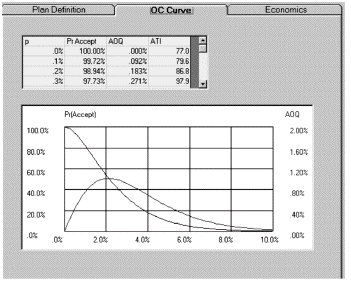

 Figure 3 shows the operating characteristic curve and average outgoing quality (AOQ) for this plan when the lot size, N, is 1,000. (Enter N, n and c into the Plan Specifications table; click Plot OC Curve; click OC Curve tab.) AOQ is for rectification without replacement; that is, bad units are discarded but are not replaced with good ones.
 The numerator is the expected number of bad pieces shipped: (N-n)PA is the number shipped, without inspection or testing, times the nonconforming portion. The denominator is the total pieces shipped: bad units shipped plus N(1-p), since all good units are shipped. ATI is the average total inspection. The plot shows that the average outgoing quality limit (AOQL) is about 1 percent when p » 2 percent, and the scrollable OC Curve table shows that the exact value (for p to the nearest 0.1%) is 1.024 percent when the nonconforming fraction is 2.1 percent. Bibliography Juran, J. and Frank Gryna. Juran's Quality Control Handbook, 4th edition. McGraw-Hill, 1988. McWilliams, Thomas P. How to Use Sequential Statistical Methods. ASQ Quality Press, 1989. Schilling, Edward G. Acceptance Sampling in Quality Control. Marcel Dekker, 1982.
