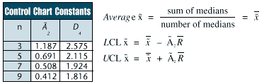

Compute the control limits using the following equations. Choose the 2 constant based on your subgroup size, n.

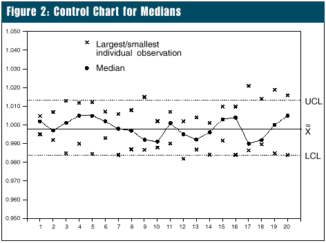

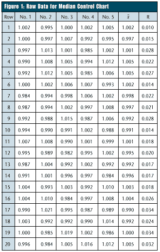

Example: Figure 1 shows the raw data. Because each subgroup contains five observations, the subgroup x is simply the middle, or third largest (or third smallest), value in the subgroup. Figure 2 shows the completed control chart. On x charts, the smallest and largest points are plotted. The chart clearly identifies the value of each subgroup. A line joins the values. The range chart must be used during the initial capability study to determine if the process dispersion is in control. The value from the range chart is also used to find the control limits for the chart.
