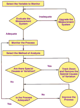

| The basic idea of statistical process control is fairly easy to explain. Let's start with a picture such as
                                                    Figure 1. This flow chart represents the basis for all quality control systems. You start by selecting a  variable to monitor. It should be one of the important characteristics of your process. Once you've selected this variable, you have to evaluate your
                                                    measurement system. Remember that all measurement systems have some error. It's important to quantify this error and compare it to the specification you're trying to
                                                    hold. For example, if you were trying to measure the diameter of a steel shaft with a pair of calipers, you could expect an error of several ten thousandths of an inch in repeat
                                                    measurements (i.e., if you repeat the measurement of the same part in the same place in the same way, you will get a slightly different result each time).
                                                     Let's say you measure the part twice, and the two readings differ by 0.003 in. And let's say the specification
                                                    you're trying to hold is ± 0.005 in. In this case, 30 percent (0.003/0.010 in.) of your specification is being consumed by measurement error. Clearly, that's
                                                    unacceptable. However, I haven't been able to find any guidelines on how much measurement error is considered acceptable. (If any of you know of an authority
                                                    that provides such guidelines, please send me an e-mail.) It may have to be resolved on a case-by-case basis.
                                                     After you have a good feel for the error present in your measurements, you can begin to monitor the process. This is simply a process of measuring the variable you
                                                    have selected and keeping records. Next you select a method of analysis. Often it's a control chart. Sometimes it might be just a line graph or a histogram. In many
                                                    cases, you'll use all of these and other tools. Remember, the goal is to study the process and learn what makes it change.

                                                     Once the process is operating or close to operating in a state of statistical control, use a process capability study to determine whether the process is capable.
                                                    Specific instructions for conducting such a study can be found in any good book on SPC. If the process isn't capable of providing a good Cpk, it will be necessary to
                                                    redesign it. Even if the process has a good capability ratio, your job isn't done. It's essential to continue to monitor the process for as long as it is in operation. One
                                                    strange belief I've run across is that a process study should be brought to closure. I've never understood this. Processes change in many little ways all the time and
                                                    may start to change in larger ways at any moment. It's therefore necessary to continue to monitor them for as long as they're in operation. The way people get
                                                    into trouble is by not monitoring their processes. Unfortunately, it's pretty boring to monitor a stable process, but you might say that boredom is essential to a well-run process.
