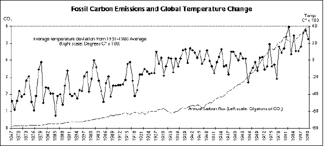

CO2 released due to human activity -- Global warming is caused by so-called greenhouse gases, which include, besides CO2, water vapor, methane and hydrocarbon. Most of these occur naturally. Figure 1 presents a line chart where the CO2 emitted by human activity is overlaid on the temperature data.
The chart shows an unmistakable increase in CO2.  From the end of the last ice age until the mid-19th century, total atmospheric CO2 varied from 260 to 280 parts per million. Since then, the CO2 level has risen to about 340 parts per million. Adding the other greenhouse gases, the total is now about 407 parts per million of greenhouse gases.
Note that between 1867 and 1946, CO2 emissions increased by about 0.9 gigatons while temperature increased by about    0.4° C. Only 15 percent of the total CO2 increase occurred during this period, compared with about two-thirds of the total temperature increase.
Based on the global warming hypothesis, the increase in greenhouse gases since the mid-19th century should have produced a temperature increase of about 1° C to  2° C, but the data show that this hasn't happened. Thus it appears that the link between the level of greenhouse gases and global temperature is poorly understood.

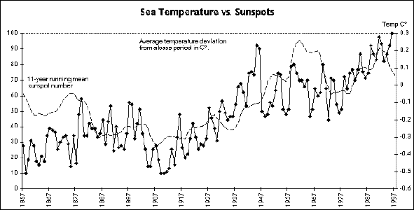

Sunspots -- Dr. George Reid, senior scientist at the National Oceanic and Atmospheric Administration, examined the sea surface temperature record for the last 130 years and found an interesting correlation with the 11-year-running mean sunspot number. Figure 2 shows the correlation between sea temperature and sunspots. Though not identical, the two time series have several features in common, including a prominent minimum during the early 1900s, a steep rise to maximum in the 1950s, a drop in the 1960s and early 1970s, and then a rise that continues to date. While not perfect, the correlation between these two sets of data appears closer than the correlation between CO2 levels and temperature.
