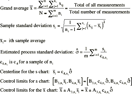

To construct an empirical control chart, one based on actual process data, first estimate the process mean and standard deviation using the following formulas. Begin with a process history of m rational subgroups. The ith subgroup contains ni measurements. c4 is a control chart factor that depends on the sample size. We will also use A3, B3 and B4, which also depend on the sample size. The control chart factors can be found on Table 3 of the Excel spreadsheet downloaded from the Quality Digest Web site. The grand average is always the centerline of the Xbar chart for sample averages. The centerline of the s chart, however, depends on the sample size. The control limits of both charts vary with sample size.

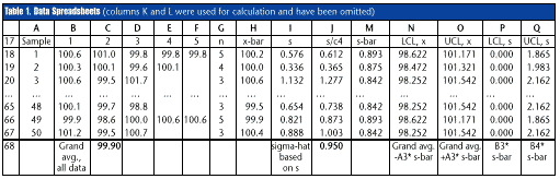

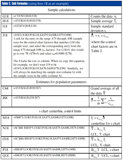

The spreadsheet in Table 1 accepts subgroups of two to five measurements, which are input into columns B18 through F67. If there can be more than five measurements, simply add more columns (columns K and L). Table 2 shows the formulas needed for each cell, using row 18 as an example.

Once a stable process has been characterized and the chart is ready for use, freeze the population parameter estimates, C68 and J68. Don't let the spreadsheet recompute them with every entry. Set aside two empty cells for the estimates for process mean and standard deviation. Copy $J$68 and $C$68 into those cells. This will copy the formulas as well. Then, delete the formulas from $J$68 and $C$68, and replace those cells with just the values (not the formulas) that they previously contained. Should you need to recharacterize the process in the future, copy the formulas back into $J$68 and $C$68.

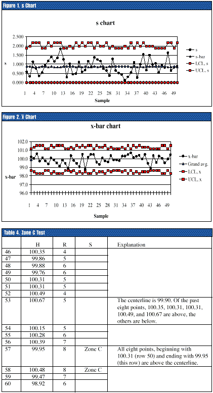

Use the chart Wizard to create the control charts (select "line chart" within the Wizard). For the s chart shown in Figure 1, plot columns I, M, P and Q, rows 17 through 67 (s, s, LCL, UCL, in Figure 1). The user can select line styles, colors and markers for each parameter. In this example, the lower control limit is zero because the sample sizes are five or less. The centerline and the upper limit, however, vary in response to the sample size.
For the x-bar chart shown in Figure 2, plot H, N, O and C$68 (Xbar, LCL, UCL, X2bar). The centerline is constant, but the control limits move in response to the sample size. (There is only a single marker for X2bar. To get a continuous line for X2bar, a new column would need to be created.)

The spreadsheet can perform the Western Electric zone tests automatically. Table 4 shows how to detect eight consecutive points above or below the Xbar chart's centerline. This is the Zone C test. Column R counts the points (out of the preceding eight) that fall on one side of the centerline. Column S does the same, and the user need not look for an "8." Instead, column S is blank unless the chart fails the Zone C test. This is an exception-type report, and it can apply to any statistical test.
Sample calculations:
R56: {=MAX(SUM(1*($H49:$H56> $C$68)),SUM(1*($H49:$H56<$C$68)))}
"Maximum of (Points out of the last eight above the centerline, points below the centerline)" The brackets denote an array summation; press Control-Shift-Enter when entering the formula. When copied into R57, for example, the formula changes to {=MAX(SUM(1*($H50:$H57>$C $68)), SUM(1*($H50:$H57<$C$68)))}
S56: {=1*(MAX(SUM(1*($H49:$H 56>$C$68)),SUM(1*($H49:$H56<$C$6 8)))>=8)} This is like R56, but a little more sophisticated. If there is a run of eight points above or below the centerline, the result is 1. Otherwise, it is zero. The cell format is: [=0]" ";[=1]"Zone C"
That is, a blank space if zero, "Zone C" if one; the point fails the Zone C test.
Similar automatic detection works for the other zone tests. To perform the Zone A test in row 57, for example, use the formula {=1*(MAX(SUM(1*($H55:$H57> ($C$68+0.667*($C$68$N57)))), SUM(1*($H55:$H57<($C$680.667* ($C$68-$N57)))))>=2)}
Cell format is: [=0]" ";[=1]"Zone A"
That is, are two or more of the last three points above the centerline plus two standard deviations (two-thirds of the distance between the centerline and a control limit)? Are two or more of the last three points below the centerline minus three standard deviations?

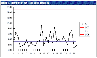

The X chart control limits are [0.779, 15.25]. These are not the mean ±3 sigma, but the lower and upper 0.135-percent tails of the gamma distribution. The false alarm risk for a traditional Shewhart chart is 0.135-percent at each control limit. The centerline is 3.081, which is not the mean but the median (50th percentile) of the gamma distribution.
Excel has no built-in routine for fitting a gamma distribution to raw data, but it can compute its percentiles. Table 6 shows the raw data and the calculated control limits for the first 10 points.Xtab6
The formula for cells B3 to B32 is =GAMMAINV(B$1,1.625,1/0.558)+0.74. Excel computes the 0.00135 percentile for a gamma distribution with Alpha =1.625 and Gamma =0.558. (The function argument uses Beta =1/Gamma as the scale parameter--see the GAMMADIST function.) Then add the threshold parameter Deltalow =0.74 to get the lower control limit. The centerline and the upper control limit use the percentiles in C$1 and D$1 respectively. Apply the chart Wizard to the cell range A2.D32 and format the lines as desired. Figure 3 shows the control chart.
X3In practice, a point below the lower control limit, and especially below the threshold parameter, suggests a successful process improvement that reduces impurities. A point above the upper control limit suggests an assignable cause resulting in excessive impurities. The Western Electric Zone C test (eight consecutive points above or below the centerline) can be applied here. The false alarm risk for this test is the same as for a Shewhart chart for a normal distribution because the centerline of both charts is the population median. (A normal distribution's mean is also its median.)
