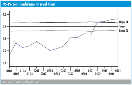

This figure shows significant improvement. Seeing this, one might ask, "How much improvement is enough?" All of Sutter Health's clinical initiative measures have targets attached to them, so one answer to this question could be, "When everyone is at target." Statistical process control by itself cannot provide the answer, so Sutter turned to another technique, developed by Dr. James, which involves "tricking" SPC software into drawing a pseudo-confidence interval chart.
To implement this technique, Sutter fixes the center line at the target (i.e., 90 percent in the case of ACE inhibitors at discharge), rather than letting the software calculate the center line. In addition, the software draws two-sigma limits, rather than the standard three-sigma limits. Finally, the rule violation labels are turned off because they have no meaning in this context. The result, as shown in the figure above, is an unusual-looking but useful 95-percent confidence interval chart (three-sigma limits would produce a 99-percent CI chart).
Interpreting the data is simple: If a data point lies outside the 95-percent "envelope," it is significantly different from (i.e., higher or lower than) the target. Points inside the envelope do not differ, in a statistical sense, from the target.
In the present (fictitious) case, we see that although Sutter St. Elsewhere made significant positive progress from an SPC perspective, it took the hospital more than three years to move its ACE performance into (and beyond) the target zone.
