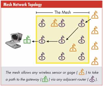

The mesh network topology (see figure above) stands out as a robust approach to covering large areas with radio connectivity. This type of network is similar to a cell phone network, with multiple transmitter/receivers (i.e., routers) relaying data throughout the shop floor. The robustness offered by the mesh network topology can't be equaled by any of the other common network topologies. In the world of "wired" networks, the mesh topology proves more expensive because of the large number of cables and connections required. However, when employing wireless communications with radio devices equipped with the right antenna at each network node, the network topology inherently becomes a low-cost mesh network.
In a mesh network, the reach or range can be extended, redundancy added and the general reliability of the network enhanced by simply adding more routers. This may be needed to provide a best route for the radio signal, thereby increasing throughput and reducing congestion. All routers in a mesh network can communicate with two or more other routers. If one radio/network node can no longer operate, all the rest can still communicate with each other, directly or through one or more intermediate nodes. This precludes the practicality of point-to-point or daisy-chain network approaches (see figure below). The latter has a single point of failure. If one router in a daisy-chain configuration ceases to function, there is no capability for the network to recover. Therefore, the data to be sent will never reach their destination. Mesh networks "self-heal" in that if interference enters the environment, such as a large EMF plume from an induction hardener, the network has alternate paths for the data to traverse. In this way, data can reach their intended destination.
