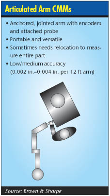

Articulated-arm CMMs, such as the FaroArm, fall under the category of “large-part noncontact measurement systems,” not because they’re capable of scanning a large part but because they’re flexible and portable enough to work around a large part.
