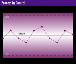

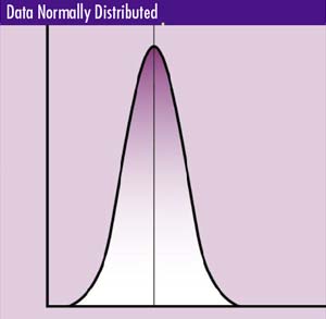

 Faylior reminds Thesia that the process must be identified as stable or in control prior to pursuing capability analysis -- much like the patients who are served by In A Heartbeat's products. Thesia has created a control chart from the data that she has gathered, using a sample size of five, to check the stability of the process. She then needs to verify that the data reflects a normal distribution by applying a chi-square test (see Quality Digest, April 2001, page 24). Thesia finds that the data can indeed be considered normal, based on this test, and is pleased that the capability analysis can proceed. "So far, so good," she reports to Faylior.

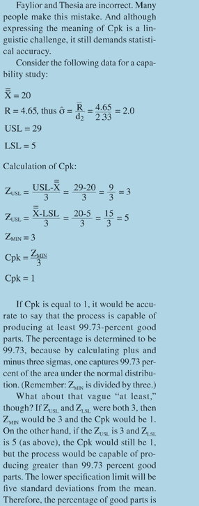

 After carrying out the capability study, Thesia sees that the Cpk is 0.74. Pondering the meaning of the outcome, she tells her partner that the process is "almost 75-percent capable." Examining her data and the ensuing outcome of the capability study, Faylior is convinced that, in light of that percentage, the process is indeed "capable enough" for this customer. Are Faylior and Thesia correct in their assessment of the situation? Exactly how capable does a process need to be?
