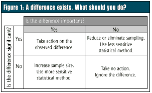

However, problems arise when these test results are presented to nonstatisticians. In common parlance, "significance" and "importance" are synonymous. When statisticians speak of "statistical  significance" (often dropping the "statistical" and adding to the confusion), then "importance" and "significance" bear no relationship to one another. In fact, the following can be said:
Qdbullet A difference or effect can be important but insignificant.
Qdbullet A difference or effect can be both significant and important.
Qdbullet A difference or effect can be unimportant and insignificant.
Qdbullet A difference or effect can be significant but of no importance to the situation at hand.
In short, "important" and (statistically) "significant" are not synonymous. Consider the following examples:
Qdbullet Important but not significant -- A hospital's fatality rate for coronary artery bypass surgery doubled from one week to the next. The loss of life clearly is important. However, if the average death rate is low -- say, 0.5 percent -- and the sample size is small -- 100 surgeries per month -- then one month's fatality rate can double the previous month's without being (statistically) significant.
Qdbullet Significant and important -- A part's average hole size falls below the lower control limit, and the part won't work in the field. This agreement in meaning between significant and important is, however, purely coincidental. The fact that it often occurs only adds to the confusion in other circumstances.
Qdbullet Unimportant and not significant --  The part's hole size changes by a statis-tically meaningless amount, and the part still functions perfectly. Again, agreement in meaning here can cause confusion at other times.
Qdbullet Significant but not important -- Carpenter A saws wall studs to within ±1/64" of the nominal length, while Carpenter B saws them with twice the variation at ±1/32". The contractor can tolerate ±1/8". Because each carpenter cuts many studs, even small differences are statistically significant. However, a difference of only 1/64" in a sawing process's total spread is of no economic or architectural importance.
Significance is a technical term when used in statistical science. It has a precise meaning as determined by the statistical test being applied. While not advisable, it's possible to determine statistical significance without knowing what the numbers mean or how the results will be used.
Importance, on the other hand, is a nontechnical term. The questions being answered are implicit: Important to whom? Important for what purpose? Unlike analyzing statistical significance, pat answers can't be given in advance regarding a particular number's importance. spc1
It's important to think before reacting to an observed difference, whether it's significant or not. Figure 1 provides some useful guidelines for the thinking process.
