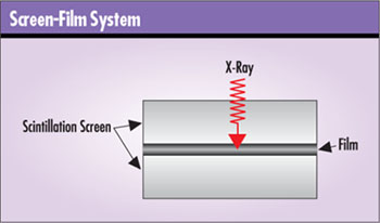

During the next half-century, X-ray technology--although constantly refined--didn’t change drastically. X-rays were emitted from a source, passed through an object and detected either on film or a fluorescent screen. Contrast and spatial resolutions improved, as did film speeds and control over X-ray sources. Scintillation screens were also used with film to achieve better images at lower dosage.

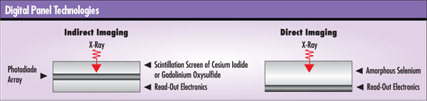

Currently, two digital flat-panel technologies are battling head-to-head for the market: amorphous selenium (a-Se) and amorphous silicon (a-Si). Outwardly, they both function in the same manner: X-rays are picked up by the panel, which converts them into a digital image that can be read from the plate. Because the panels require no processing, images can be obtained at rates of one image every few seconds up to live video speeds of 30 images per second. Because of their better resolution and increased field of view, flat panel displays with 30 images-per-second speed are ideal replacements for image intensifiers. However, depending upon the manufacturer, the 30 image-per-second frame rate may come at the cost of decreased resolution.
With amorphous selenium technology, X-rays strike an a-Se layer, which converts them directly into an electric charge that’s further converted to a digital value for each pixel. This is called a direct-imaging method. Proponents of a-Se say it offers better spatial resolution than a-Si.
With what are commonly called amorphous silicon panels (a misnomer because even a-Se panels use amorphous silicon), X-rays first strike a scintillation layer. This layer emits photons in direct proportion to the energy of the X-rays striking it. The photons are picked up by the underlying a-Si photo-diode matrix, which converts them to an electric charge. This charge is then converted to a digital value for each pixel. Because of the intermediate step of converting X-rays to light via the scintillation layer, this is called an indirect-imaging method. The scintillation layer is commonly composed of either cesium iodide or gadolinium oxysulfide, with CsI being the preferred material. Proponents of a-Si panels say they offer much faster frame rates, up to 30 images per second, than a-Se panels.
Both technologies offer near-film spatial resolution but with contrast ranges far exceeding film.

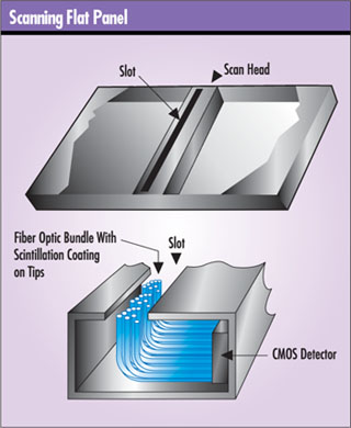

With all the buzz over a-Si and a-Se flat panels, some other flat-panel technologies might be overlooked but shouldn’t be, such as the CMOS X-ray. This interesting new product from Alaska-based Envision Product Design (www.cmosxray.com) is a scanning flat panel. It consists of a linear X-ray detector array and drive system housed within a flat panel 3 in. thick. The panels can measure up to 24 X 36 in. and are used in the same fashion as the ones described earlier.
With this technology, as the scanner traverses the panel (think document scanner), X-rays pass through a slot that collimates them before they strike the scintillating material. The material is deposited on the ends of a fiber optic bundle that runs the length of the array (see illustration to the right). In an arrangement that protects the X-ray-sensitive CMOS detectors from X-ray damage, the fiber optic bundle leaves the scan head at a right angle to the X-rays and connects to the CMOS detectors, which are housed beneath tungsten and lead shielding. The system can be built to operate with high-energy X-ray systems up to 10 MeV.
Alternatively, Envision sells CMOS linear arrays up to 6 ft long that can be fixed in one place while parts are moved past robotically or on a conveyor system. The image on this issue’s cover (minus the rider) was taken by moving the motorcycle in front of a 54 in. linear array. The 54 X 84 in. image took 110 seconds to acquire.
Envision flat panels and linear arrays have spatial resolutions of 80 µm and contrast resolution of 12 bits, or 4,096 gray levels.
