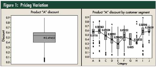

During the emergency meeting, the vice presidents of marketing and sales emphasized the tough external environment and the importance of pricing. The pricing manager showed two slides (see figure 1, below) that reflected the wide variation in discounts--from 5 percent to 95 percent--offered to customers within a single stock-keeping unit (SKU), regardless of the customer’s size or even the transaction.
Senior managers began to understand that this variability was a problem and symptomatic of process issues. Acme had enjoyed considerable success in reducing manufacturing variability by applying Six Sigma. The managers felt that the transaction- pricing process was similar enough to a manufacturing process to warrant piloting a Six Sigma pricing project in one of the company’s North American subsidiaries. They appointed the manager from pricing to carry out the five Six Sigma DMAIC steps: define, measure, analyze, improve, and control, with the help of a Master Black Belt recruited from manufacturing. The project sponsor was the senior executive responsible for pricing.
