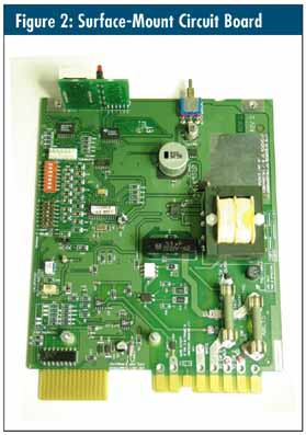

D-M-E circuit board using a surface-mount design rather than the more traditional through-hole configuration, which is not WEEE-compliant.

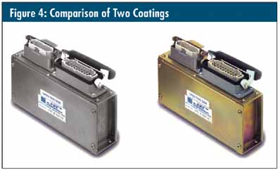

When shown side by side, the color difference is very clear between trivalent chromium (right) and hexavalent chromium materials.

For electrical-board layouts, D-M-E had to change from a through-hole to a surface-mount design. With the former configuration, lead components were actually stuck through the circuit board to hold them in place, causing contamination to the solder pot over time. With the surface-mount design solution, lead components sit on top of the circuit board rather than penetrating it, eliminating contamination. As another benefit, surface-mount boards are easier to recycle, facilitating WEEE compliance, as seen in figure 2, right.
The configuration change didn’t completely solve the problem. To create a surface-mount circuit board, components are attached using a solder paste screened onto the face of the board. The board is then moved through an oven to melt the solder paste. However, the high-process temperatures required to melt the paste can cause problems with the components and boards, potentially affecting product longevity.
D-M-E designed a new oven-heating process for adhering components to the electrical boards. Using precise timing and a single pass through the oven rather than multiple exposures to the intense heat, D-M-E ensured proper connection with minimal heat stress to the components.

With electrical enclosures, D-M-E needed to eliminate hexavalent chromium, a restricted material often identified by its yellowish color. The challenge was finding a cost-effective equivalent that offers the same corrosion resistance. D-M-E switched to trivalent chromium, a silvery, compliant material that offers the same level of corrosion resistance and the same cost of plating, as seen in figure 4, at right.
