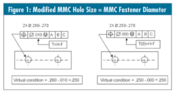

As an example, let's assume a hole diameter of .260 - .270 (all figures in inches) and a fastener diameter of .250. Both H and F will be the MMC value of the respective features. So, H (.260) - F (.250) = T (.010). The problem with this method is that holes less than .260 (down to .250) aren't allowed regardless of their location.
Now this is where zero is more. We're going to modify the formula slightly to read T(0) = H - F. Now we have a value of zero that the MMC hole minus the MMC fastener must satisfy: H(.250) - F(.250) =T(0).
In other words, we have modified the MMC hole size to equal the MMC fastener diameter. The new hole size is a .250 - .270 diameter, and the location tolerance is zero at MMC. Virtual condition remains unchanged. (See the example in figure 1.)

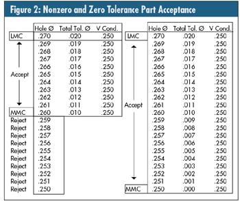

In the example seen in figure 2, for the nonzero toleranced part (left side of graphic), the range of acceptance falls off at the MMC hole size, which is far short of the virtual condition. Any hole size less than .260, regardless of its location, should be rejected.
The range for the zero tolerance part (right side of the graphic) is equal to the virtual condition and will allow acceptance of all parts that meet the hole size and location requirements.
