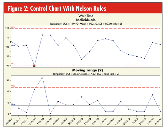

Lloyd Nelson limits for computing control limits

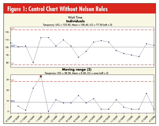

An important part of interpreting control charts is identifying special causes. A sudden change in the data may render the moving range out of control, for example. This spike in the moving range artificially widens the control limits on the individuals chart, making it more difficult to identify special causes. By not catching a sample that is out of control, you can miss an opportunity for improvement, as seen in figure 1.
The Lloyd Nelson limits (often referred to as the "Nelson rules") render individuals charts more effective in identifying special causes by removing any moving range values that are above the upper control limit (UCL). This can be a better option than marking the sample as a special cause. When a sample is marked with a special cause, it is eliminated from both the moving range and the individuals chart calculations. The Lloyd Nelson option removes the sample from only the moving range and keeps the sample on the individuals chart. To ensure this kind of precision, make sure that your software provides the Lloyd Nelson limits option so that you don't miss any opportunities for improvement.
Figure 2 shows the same two charts as shown in figure 1 using the Lloyd Nelson control limits option. There is clearly an out-of-control condition on the individuals chart that was missed using traditional techniques.

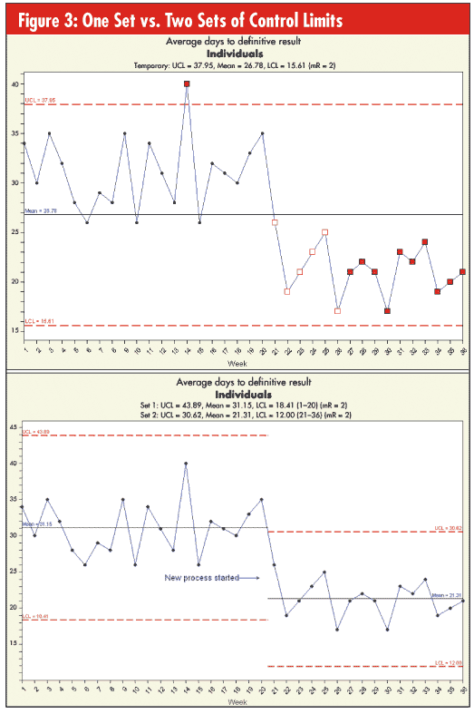

Control limits reflect process changes
When using control charts for process improvement, one can expect to see changes in the process over time. As a process improves, control charts must be able to reflect the new reality. If the data on a chart show a significant improvement or change, the chart should communicate this with multiple sets of control limits. For example, it might be useful to see one set of limits before the improvement has been made, and another set of limits after the improvement. This visualization of an improving process can be a powerful way to communicate feedback to workers in the process as well as to management, board members and other stakeholders. (See figure 3.)

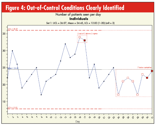

Out-of-control conditions clearly identified
Some out-of-control conditions are easy to spot. A point above the upper control limit or below the lower control limit is usually obvious. However, other conditions can be more difficult to see. For example, the run rules, such as seven points increasing or decreasing, and the zone rules, such as two points beyond two sigma, can be hard to pick up at a glance. In these cases, the software should help by visually showing a difference and by labeling the out-of- control conditions on the chart, as seen in figure 4.

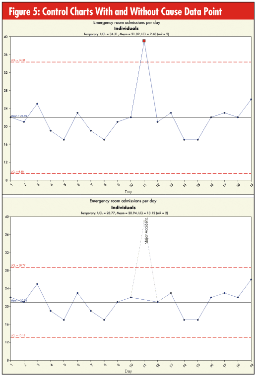

Assignable causes shown but unused in overall calculations
When data are being collected on a key metric for use in a control chart, one is likely to encounter unusual data values. These values can be significantly different from the typical values—different enough to distort the control limits and change the scale of the control chart. Usually, some reason or special cause can be found for these values.
One needs to re- cord these data points for historical study, but without affecting the control limit calculations. Control-chart software should have a mechanism for handling assignable causes. When a point is marked with an assignable cause, it should show up on the control chart, but it should not be included in the calculations, and it should be visually different from the other data points. (See figure 5.)

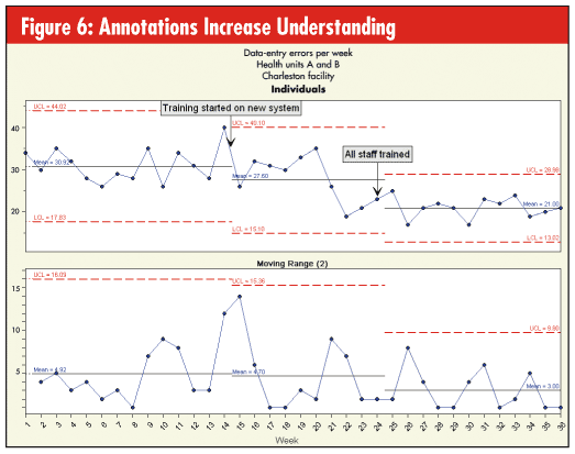

Annotations used to increase understanding
Sometimes, a word is worth a thousand pictures. A control chart can be rendered more useful with the addition of some well-placed text, lines and arrows. These chart annotations can document process changes or note important events that affect the chart. As long as one is careful not to overuse them, annotations can be an important addition to most control charts, saving time during analysis. (See figure 6.)
