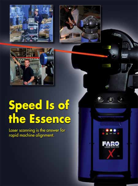

Laser trackers
With this in mind, survey consultants who align casters, rolling lines or processing lines must work thoroughly—and fast. Several years ago, Falk's work at the superconducting super collider introduced him to the FARO Laser Tracker, which bounces a beam off a movable spherical retroreflector target and then automatically calculates the position of the target to a 3-D single-point accuracy of 0.001 in. The system can be set up on a tripod in almost any manufacturing environment and gather data in a matter of minutes, in temperatures that range from –15°C to 50°C (5°F to 122°F).
Operating speed is no limitation—the instrument makes 10,000 samples/sec. The tracker ensures that data collection is smooth by visually tracking the motion of a retroreflective target held by an operator or mounted on the device to be measured. If a pillar, motor or other obstacle interrupts the beam, the tracker easily reacquires it and data gathering continues. The niche for this system is using its thousandth-inch accuracy to measure huge objects within a 230-foot range.
