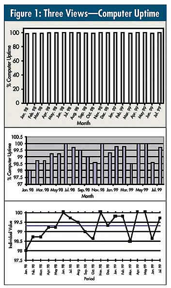

Figure 1 shows three graphs of the same data (percent computer uptime). The one at the top uses an origin of zero (which is more common than you'd think). The middle graph lets the program default to a scale. Contrast these with the run-chart analysis at the bottom: No trends, no runs of eight and nothing unusual about achieving 100 percent... merely luck. Common-cause strategy, anyone (matrix of downtime)?

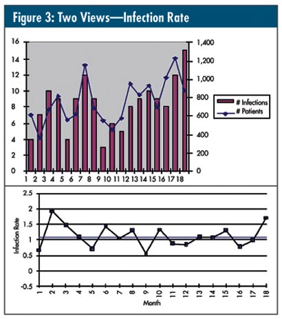

I've noticed that the "two-scale" syndrome seen in figure 3 is also very common. Note the differing left and right vertical axes. The horizontal axis is "time." This poster touted a profound change, but a run chart of the rate showed otherwise.
When are we going to stop taking the easy way out by giving in to what our customers "expect" or, worse, staying silent and tolerating meetings where useless displays like the example above and those shown in my past two columns result in destructive managerial actions? This kind of display does no one--least of all quality professionals--any favors. So, to quote the famous clip from the movie Network, join me:
